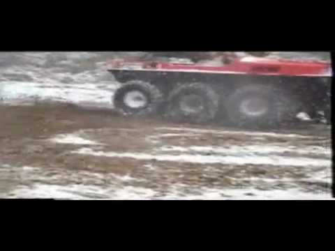

                            • great Argo action in the snow
                              This asian man is really enjoying his argo in the snow !

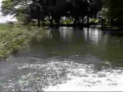

                              • Argo humanitarian aid video
                                I found this humanitarian aid video of an Argo being used to bring food to flood victims in Costa Rica . This video shows how versatile the 8x8 Argo avenger is !
