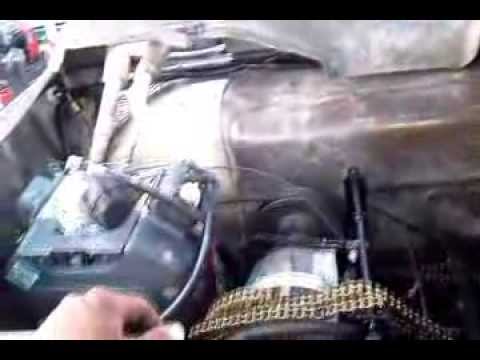

I took it apart and put on a winch mount, built a belly band, and got everything ready to take my new hustler hunting this year. We only put maybe 35-40 miles on it but we figured out a few things.
I liked the way it ran, motor had enough power, but it could use more. And it seemed to me it could use to be geared down a hair.
So here we go Hustler rebuild version 2.0
I scored a new welder so before i took it back apart i made a winch guard and got new tires.
Got it apart and noticed the frame was bent. Had to reinforce my shop press so i could use it sideways. (did i say I SCORED a new welder?)
Starting the first reassemble. Figured i would put it all together on the frame first then re install it all back in the tub since i have to drill holes for the set screws on the sprockets anyway.
New bearings inner and out, new Apache gear axles and sprockets.
I was going to put double collars on all the bearings.
and that's as far as i got tonight.
