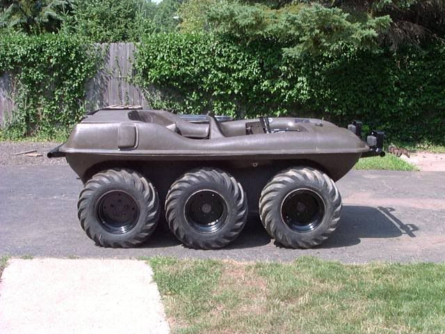

    Thanks everyone, I appreciate the kind words. And Mike, the Hustlers did come with solid axles. The axles are 1 3/16" but on the inner part of them they are machined down to 1" so my inside bearings were the same as 71+ Attex inner bearings and they were pretty easy to locate when replacing, but finding 1 3/16" tripple sealed outter bearings wasnt very easy.
    Heres a pic of the BIGFOOT in the daylight.

      That is one big mutha. Nice work Jeff. Can't wait to ride with it...

        WOW! Looks great, a nice roll cage and your ready to go.
