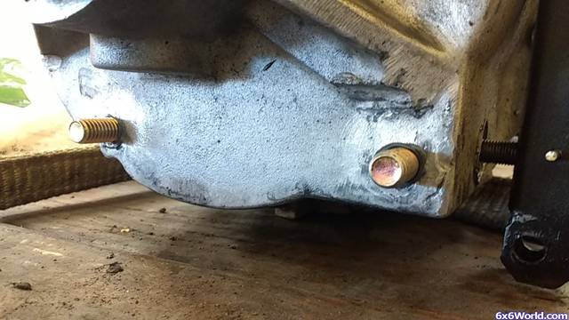

    Here is one of the boogered mounting holes in the T20. You can see how it had dropped into the mount and scrubbed the side of the case pretty good.
    Step one of the repair:
    Epoxied-in grade 8 studs. I forgot that I had already drilled and tapped these from 3/8" to 7/16".

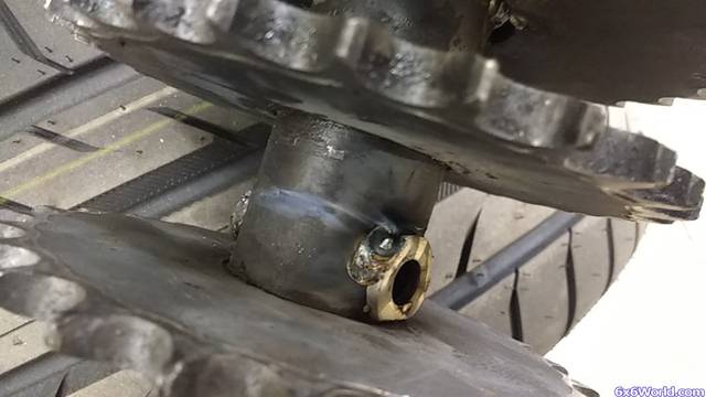

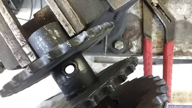

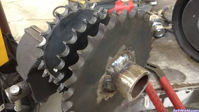

              So my fabricator friend wasn't able to inexpensively source a piece of steel to cut a sprocket with his cool laser. He said it was some weird uncommon thickness. Richards Relics didn't have any sprocket assemblies that matched mine. BUT, I did find two matching #50 sprockets at Tractor Supply yesterday. I'll just have to replace the sprockets on both left and right sides. They are 30 tooth instead of 35 tooth. In my pea brain it'll be okay since these are the sprockets on the center axles chained to the trainsmission. So, I'll be going a bit faster, which is NEVER a problem... Hahahaaa. I left my high school math in the 90's, but I think going from 35 to 30 is a 14% difference? so if I'm going 30 mph now, I'll go 34 with these sprockets? I dunno. math.

                Have you looked at McMaster-Carr? They have a 35 tooth No. 50 sprocket that could be machined to fit your existing sprocket tube. Just cut the old off and weld the new one on after it is bored to the right diameter. https://www.mcmaster.com/ansi-roller-chain-sprockets
                I'm not trying to keep you from going faster, though.
                  Try Surplus Center

                    FINALLY found some time to get the sprockets over to my fabricator friend to weld up. He did one and I did the other. I also took the opportunity with both center axle sprockets out to weld in some thick grade 8 washers to fix my oblong sprocket bolt holes. It welded up super easy, but there is still a bit of play just in the size difference of the bolts and washers. With the Hustler completely in the air it's amazing to see how much play there is between all the wheels. The center axles were the worst about breaking bolts, so I'm hoping this was a big fix.

                      Back in business! The smaller sprockets make a noticeable difference.
