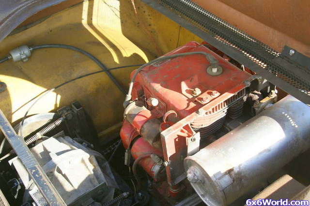

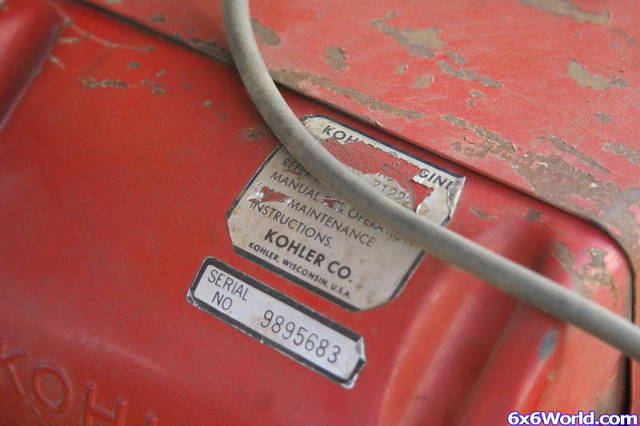

        My Hustler has the red Kohler 1 cyclinder in it.
        I took some pics of it this afternoon.
        I have noticed that when I put it in reverse I cannot turn. Is this common in a Huster? It goes backward but that's it.

          If you cant turn in reverse, STOP DRIVING THE VEHICLE RIGHT AWAY. The problem is that one of the brake bands in your T-20 transmission is bad. Take it apart and replace it right away or you will damage one of the drums and you will be in for a very expensive repair. You can get a new brake band from Recreatives Industries, since they build the Max AATVs with the same T-20 skid steer transmissions that the Hustlers, and many other AATVs came with. Good luck with the project!

                        So the transmission can be fixed. I did drive it around the parking lot today but nothing off road. I did notice that there was some fluid under the tranny.
                        Skid aka Joe
                          As far as the transmission, it can be fixed and while its all opened up you can put in new case gaskets and steering plunger O ring seals. This will prevent any leaking of fluid. Make sure when you fill it back up you use 1 quart of ATF type F fluid and add about 4 ounces of anti slip differential additive to help prevent the bands from "chattering." I saw that machine for sale on Craigslist for a while. I think the last time it was on, it was down to $1100 or so. I love that roll cage on there too. I've seen that before on some other Hustlers and Sidewinders, is that aluminum?
