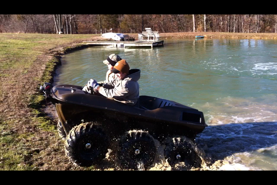

                  Got to run my Hustler a little more. I can't get enough of pics of these machines climbing out of water. Here's the best I got from this ride.
                  1984 Hustler 980 and some other toys that won't even swim.
                    Awesome shot, makes me sad mine is in pieces...
