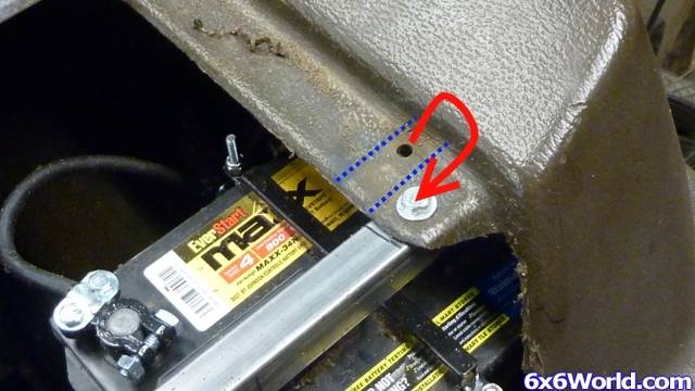

    In the first picture. This is how mine looked. Even the
    heavy mesh screen didnt follow the body contour. The 1" square tubing that had the hinges on it for the lid was mounted to the top of the opening.

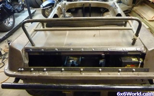

    Yeah seems to be a common thing with the engine /rear upper body on these. Makes ya wonder if they ran out of beer, went home for the night and just never got back to it.
    Liking your work, it's looking good.
