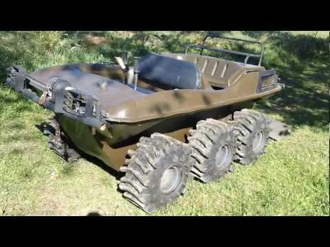

                Here is a walk around video of the Hustler 980 IC.
                Enjoy, Keith.
