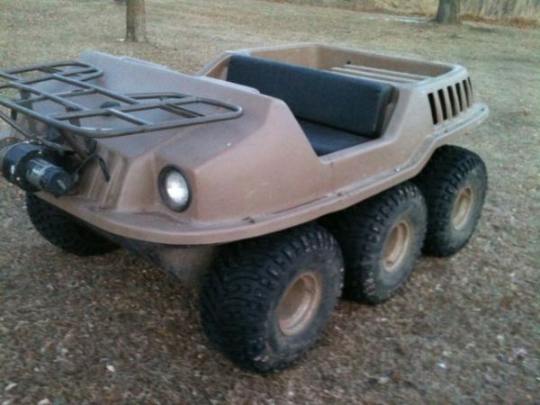

            The deal fell through, but another opportunity has opened up. Its a 94 Max II, the gentlemen has stated that he redid the sprockets and chains, not sure on the bearings. But from the sounds of things it was well maintained. It has a B&S but I did not get the HP on it. Newer tires and comes with the winch and front rack. Going to look at it tomorrow night.
              Just keep in mind that those tires won't swim, so if you plan on using it in the water you won't really go anywhere. How much is he looking to get for it?
              I have a lead on a very nice, very low hours 1996 Max II with a 16HP Vanguard, turn key ready to go. Let me know if you're interested.
                I own 120 acres which encompasses the shoreline around two small lakes, so yes we will be in the water. I have a 35 lb thrust Minn Kota trolling motor with remote steering I plan on hooking up via a mount on the trailer hitch. Have a spare battery on a barrel switch to go back and forth for charging. Most we use our canoe's for is getting across the lake to get to Duck Blinds.
                There is just no deals in my area and this is the cheapest thing we can find on Craigslist. I'm sure you can probably snag a good deal on the '96 than what I am looking at for this '94, but then the issue would be getting to Minnesota.
                Going to look at it this afternoon. If I end up getting it, i'll be sure to give a better review with pictures.
