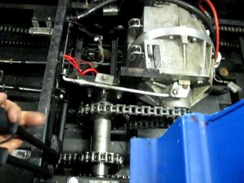

          Here is mine: T-20 split shifter - YouTube The 2 levers together allow one hand to push on both at the same time.
          My next project is a MaxIV and with that one I'll try to do it with foot levers. I will also use these things http://www.6x6world.com/forums/trans...call-part.html By themselves they make shifting easier, with the loss of "feel" from a foot lever, I think they will be necessary.
