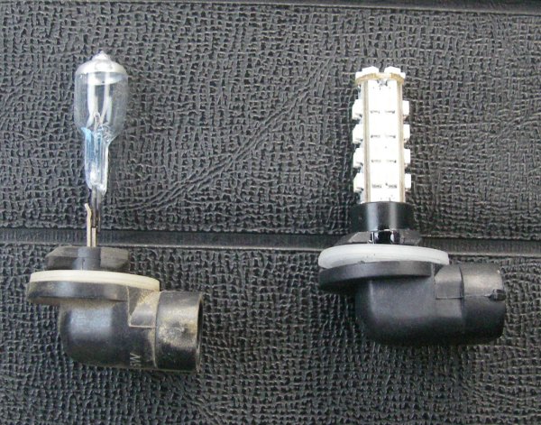

Even so I bought a pair of these LED bulbs for $30 to see if they would work:
38-SMD Xenon White HID 881 LED Fog Light Bulbs Daytime Running Light Bulbs

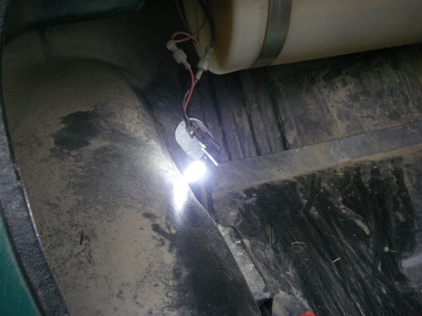

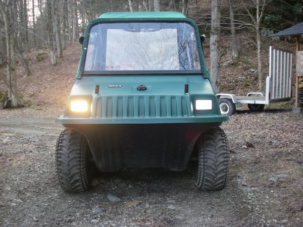

They have 38 surface mount LEDs mounted on a post and the proper base connector. The vendor doesn't list specifications but I estimated they would be as bright as the stock bulbs and draw 1/2 amp each.
I was disappointed with the result. The bulbs are quite bright and they may even put out as much light as the stock bulbs, but the output doesn't form a beam like the stock bulbs and appears dimmer. See the following pictures.
I plan to do another test with both bulbs at night when it's warmer outside. The vendor sells bulbs with 68 surface mount LEDs for $40/pair but I'd want to get the height of the post before buying them in case they're too tall to fit in the housing.
