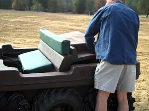

          Here ya go. The Winson diesel in this Super Swamp Fox is outstanding in the mud and swamp.
            Awesome vids mudbug, not real sure about your spring loaded seat idea but ok. My reason for starting this post was purely for ideas on this plan.
