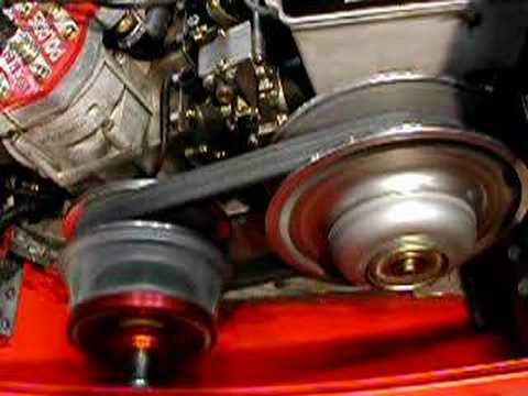

        With the machine in neutral, rev the engine and watch both of the clutches. As the engine revs higher, the clutch on the engine will close, allowing the belt to climb up the face(s) of the clutch. At the same time, the clutch on the transmission will open, allowing the belt to go down into the clutch further. The video below will give you a better visual representation than I can describe here. If you search the site, you can find some threads on adjusting your belt for the proper tension. If your belt is squealing, I would start there.
