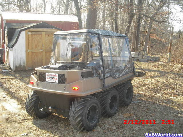

                              My MAX IV has a custom built cab on it ,but the man that built it passed away last year but you still can get a idea .http://www.6x6world.com/gallery/data...m/CIMG5086.JPG
                              Max IV has a high out put heater,custom cab, windshield wiper,suspension seat,new hydraulic brakes ,cargo rack on the front ,,,and I'm loving every minute of this .
