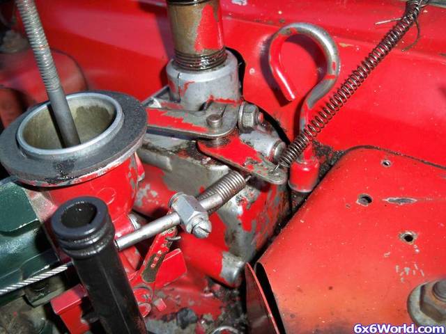

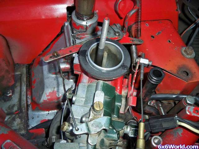

                Here are 2 pics I've found in the gallery, not sure of first with the larger spring, the second looks to be an Argo set up. Note they are both in different holes.

                  the long spring is the dampening spring that runs parallel with the metal rod on the gov arm. but being tied together solid to the gov shaft I guess you could cob a spring on either side to get the same effect. hey how do I put pics on here I did take pictures of the motor yesterday . it looks identical to the ones you posted even the missing paint and all. and that little short spring is the very stiff one iam talking about. that spring in your picture looks the same length but lighter due to the thickness. well I dug around in my garage today and had a new can of the seafoam so I added a 1 oz to the little bit of gas I had in the tank and believe it or not this motor run better. the fuel filter looks very dirty going to try and pick one up tomorrow when I get out of work. the machine definitely get right along better but when you go from 3/4 throttle to open that's were she lags and sorta dies like it has a rev limiter. so I took it out and through a large mud hole were most of the 4 wheelers get hung up here. went through it 3 times then came through it the opposite way slower because of a big rock at the end of it and I buried it. never thought this would happen I had to get pulled out by my brother and his tractor. that hurt my masculinity there I thought I had the bomb. it was fun and she is getting pretty close to running the way I would expect. do you know of any newer engines that can be used as a drop in replacement for the kohler 20 mag. I don't know why but I am beginning to love it. it even seems to turn easier and all I have more control of it. it growing on me. also think she could use a new belt . better tires a lot. but one thing at a time. would u recommend a good tire. I may pick up a few at a time till I can change all 6. oh yeah the carb in your pic has the high speed fuel adj in the top of it mine don't.
                      The top picture,per the service manual,is correct. In the other 2 pics the long spring going from the governor arm to what appears to be one of the fan shroud screws does not belong there. A "damping" spring would run parallel to the rod to take up the play from the pivots.

                        Joe, that is a forced idle spring on Magnums. It's an Argo trans thing to get them to shift smoothly, it's in the manual.
                        • #27
                          Hey Jim,
                          I was just referencing the Engine manual Kohler published,not an application specific article. That is OEM on the Argos? Wow,the good ole days! But,we're workin' on a Max here,I heard those forced idle springs only fix Argo transmissions, so it shouldn't be needed.
