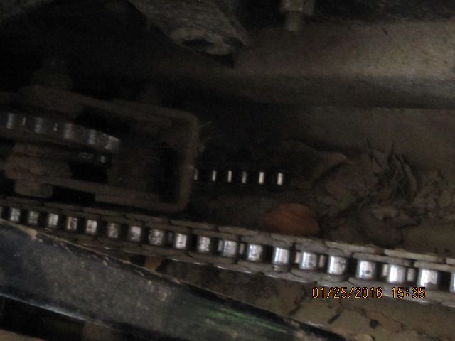

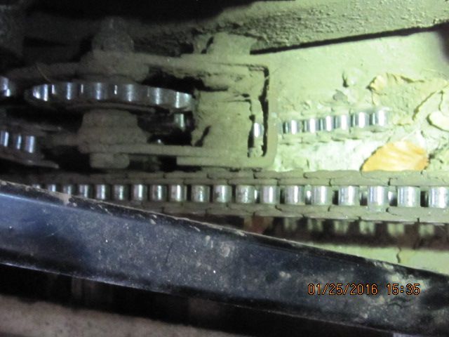

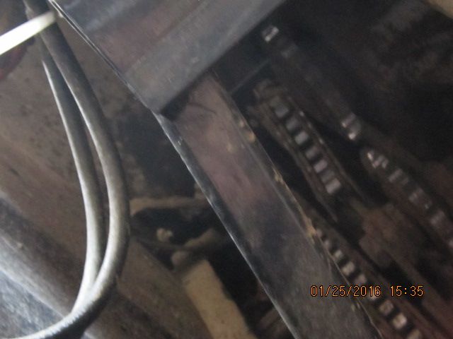

                        I have also just broken a chain in the rear of my Max 4. I am not sure if it is the primary chain or what. It is a short chain that appears to come off the engine sprocket. (See attached pics). Where can a replacement be found????

                          You can order chain online or at your local bearing supply store. Be sure you get higher quality chain. There are a lot of threads on the forum with recommendations on brands but most agree that Diamond USA chain (not the foreign version) is a good chain to stick with. By the looks of your tub and the chain, you had probably better order enough chain to replace them all. I bet if you take that chain out, it will be very stiff and/or kinked from being covered in dirt over the years. Your other chains are probably going to start doing the same thing. It's often cheaper to buy chain in 50 ft. rolls vs buying 10ft sections so you may want to investigate that as an option.
                            You can get replacement chain anywhere, ranging from cheapy tractor supply import stuff to high tensile strength Diamond or Tsubaki brand. Every Fastenal store I've been in sells it too, what you are looking for is high tensile strength, the higher the better. Quality chain will last years, cheapy chain may break and cause other things to damage in no time.
                            It looks from the blurry photo (#1) that the main drive sprocket is heavily worn as well as the tensioner sprocket. It may just be the lighting but they look shot, I would replace both of those at the same time if they are worn.
                            Regarding the chain, I buy a lot of new in the box chain from EBAY and Amazon, when I don't need it, and I've bought high end chain for less than $1/foot. Take your time and stock up, if you go out and buy this stuff retail you may pay $7-8 per linear foot or more.
