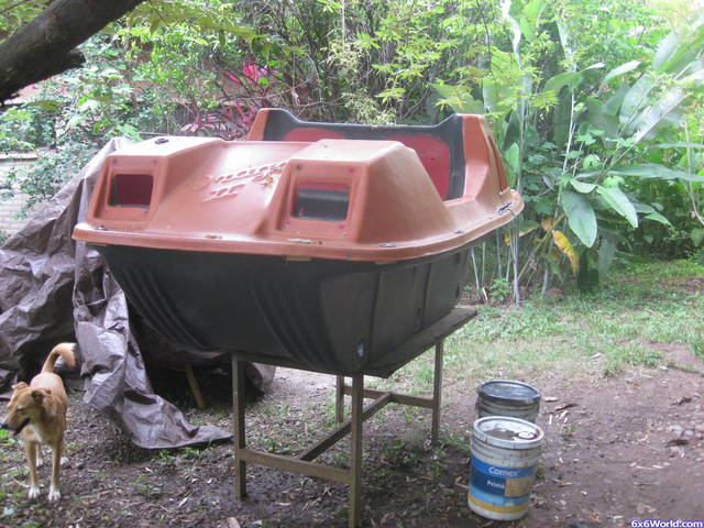

I live in Mexico and just bought a 6-wheeler branded a Drago 2. From all of the pictures I've seen I'm pretty sure its a Max 2. Right now I have it disassembled and am cleaning it up. I'm waiting on the paper work so I'm not sure what year it is.
Very interesting hwally, it does look similarly frame based.
Lets see a picture of the lower body as I don't see one in your gallery, I do like the split shifters.
The lower body seems as if it may be straight across looking at the upper body pics, the upper body seat wells look like Max and the engine access looks like early Max.
Another picture. I haven't figured out how to post multiple photos in one post. I tried copying multiple urls but only the last one shows up when I paste.
It certainly looks like a MaxII lower with the main differences quickly seen of, the 3 ribs on the bottom, the straightened body seam and where the outer exhaust hump is.
