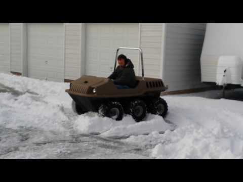

Max II donuts
I want to do the split shifter mod, just have not had time. I want to add a windshield and several other plans for this machine. I bought a used 60" Moose ATV snowplow and winch for it, but I am still gathering all the pieces and parts to get it fabbed up. I am going to attempt to weld up my own winch mount and plow mount. My brother cut out the brackets on the water jet. should have had it done before the snow. Jay
