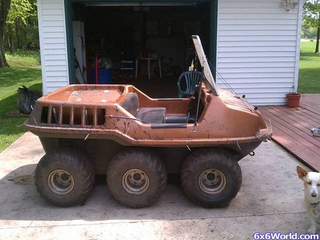

Thanks to member Jezzah, I now have a windshield on the way. Does anyone have a recommendation on something I can use for the side braces/supports? Any ideas appreciated.

I'll check local boat dealer, Jezzah sold me a windshield with the hinge, but I am going to need something to use in place of the bars that hold the windshield in the upright position. OEM unit has bars that go from upper body to windshield frame and stow on upper body side when windshield is folded, I believe.
Go to a marine store and purchase what is needed to make the windshield mount like the current style, be sure NOT to drill the holes THROUGH the GLASS or you'll be buying that also.
If you wish to make it like the older style (which it is) if the loops are on the back and screw holes on are the front, a piece of cable goes on the front with bungee cords on the rear side.sigpic

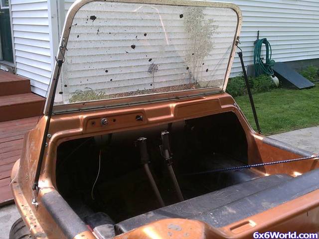

Take a look at the many types of nitrogen gas struts,LW1911. Using such will require a pivot point that allows the cylinder to apply pressure in both erected and retracted windshield position. I intend to use them for my installation.....
