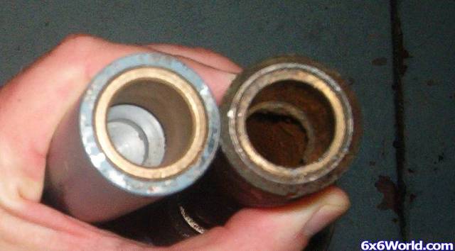

    I ordered a few of these for my new rear axles but, as I'm replacing the bearings on the front axles, my inner bushings are only worn about 2-3 mm. Should I replace these now (which means lathing them out = waiting maybe another week before my cousin can get to them) or should I just re-grease and use them until they go a little more. The axles aren't very difficult to remove on this machine due to little water use. The other question is: will this allow the new bearings to go out faster if the axle flops up and down a little?

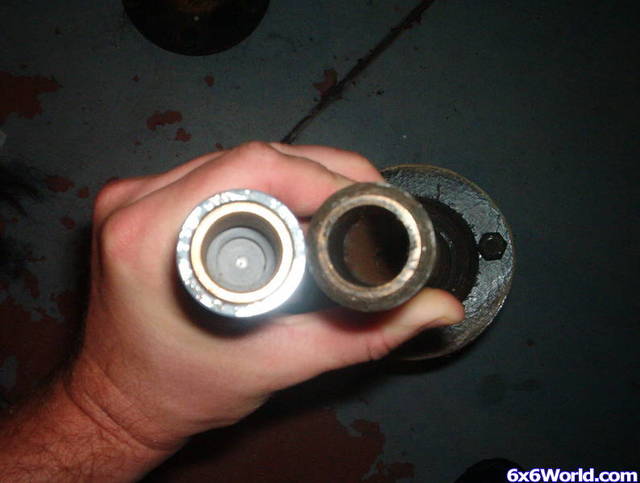

    Here's some photos to compare the new(Grey) vs old axles/bushings ...
      Looks nice, but if you want to make it last, I would drill & tap a hole for a grease zert on the O.D. of the axle to the middle of the bronze bushing. Without some kind of lubrication it will end up looking like the one on the right in a matter of hours. 2 - 3 mm is too much. The clearance between the I.D. of the bushing & the shaft should only be .003 - .005. Drill & tapping the axle for a zert fitting is something you can do with a hand drill. And also, make sure that the shaft the bushing rides on is in good shape. If it's not, it too, can ruin the new bushing. Hope this helps.

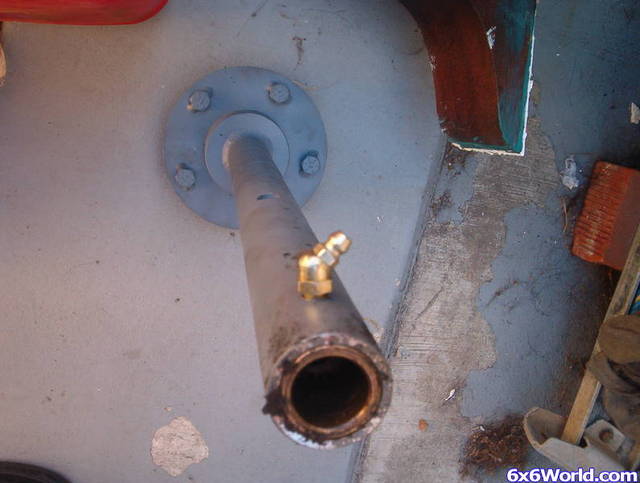

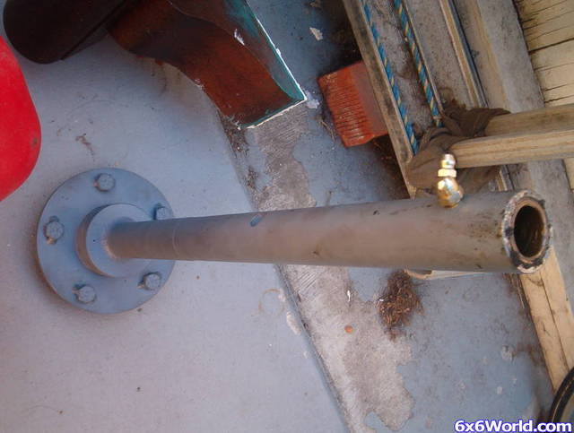

            BTW - here's one of the zert fittings I did last weekend on the new axles.
            Since these are not hollow, I drilled them out on the inside edge of the bushing.

              Good job, Mike.
