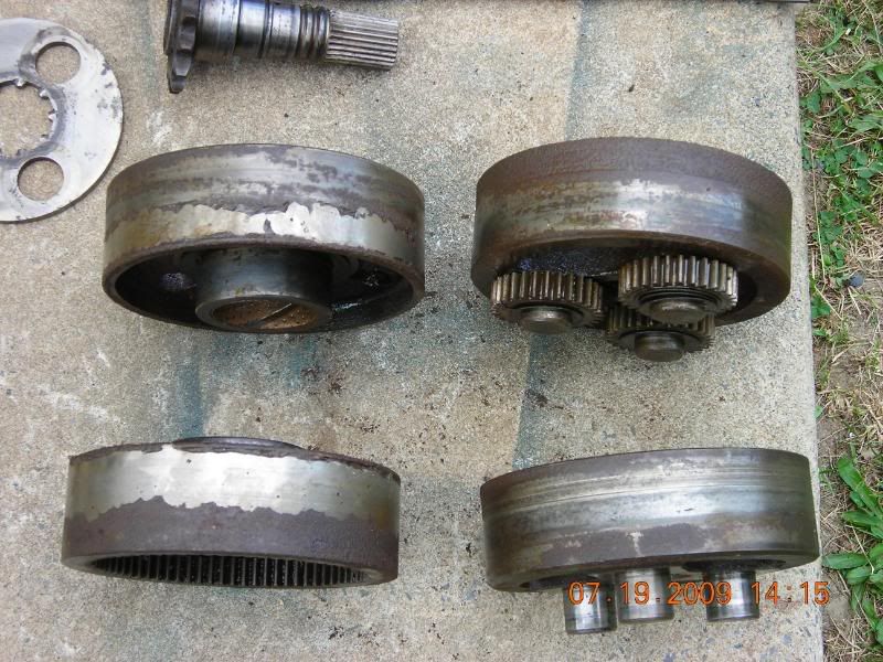

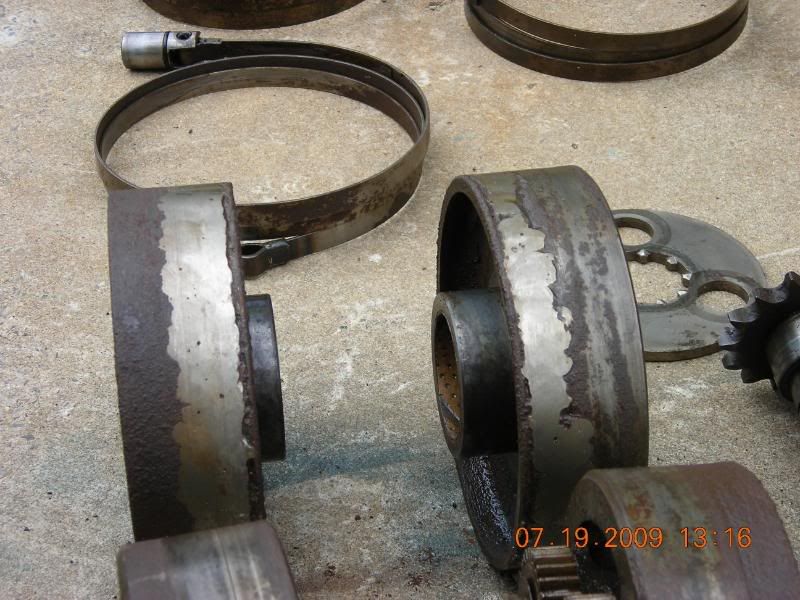

            Jay, returned my call and quoted me some prices for t-20 parts.
            Gear Drums- $250.00 per durm $500.00
            Brake Bands $ 90.00 per band $360.00
            Seal Kit $ 50.00
            Total: $910.00
            He did say you can take 10 to 15 thousandths of the face of the drums. Everything else looks fine. I'm going to replace the output shaft bearings and planet gear needle bearings, if needed. He also said I don't have to be concerned about the pitting on the drums. So, this is the first time I've ever opened one of these up. I think the Gear Drums may be shot and need replaced; What do you t-20 guys think?

                joe i think i would take them to the mechine shop and let him take .10k off them first and see what they look like . might surprise you . robbie
                  also joe look at race's gallery his t 20 was in ruff shape to he did a fine job with them he turned his too i thank . robbie
                    Robbie beat me to the punch.
                    i sand blasted them first then took ten thousandths off in the lathe. in this picture, the one on the right hasn't been turned yet. i had just put it in the lathe and polished with emery cloth. i don't have the #'s in front of me, but i did the math and figured that you will have to run the adjuster bolts on all 4 plungers about 2 turns tighter to get proper adjustment.
