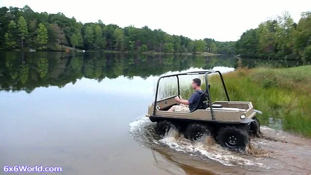

After her test we loaded up and headed to a pond nearby for a water test. I wanted to test it for leaks, see how it was balanced in the water and test the tires' swimming ability. It floated pretty level and didn't leak at all but the tires were a little tricky. Here's a video of my first drive in the water. It took me a few tries to figure out how to turn but I finally got the hang of it.
If you are going slow you can steer normaly but at anything over 1/4 throttle the car actually steers towards the side with the tires spinning. Very strange to get used to but essentially the tires seem to be pulling the six wheeler down in that direction making it steer that way. These older bodied Max IVs have lower tubs than the newer ones and I had to remold the body over all of the tires to get them to fit so perhaps that is why it acts differently than other Max IVs with the ASX tires that I've seen here on the site. I look funny when trying to turn the first time or two in the video because I'm leaning the opposite direction from the way it's turning.
Regardless, I like the tires a lot, they do swim about like the rawhide IIIs and we'll see how they do in the mud this coming weekend.
