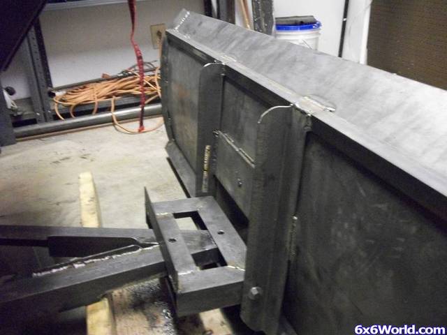

    Ok, this is my take on a snow plow for my Max IV. Certainly not done yet- needs the springs, some pins here and there, a wear bar on the bottom edge and some other "stuff" but I need to make a trip for parts.
    I'm not sure I want to make my mounts over on the bearing flanges (they would catch a lot of "goo" when just out riding without the plow) and it seems like they would hang up once in a while.
    I'm thinking of making my mount on the lower tub, bolted to a backing plate that is in turn bolted to the front of the frame (kinda like the rear hitch). It looks like I could blend it into the angle of the tub and not have anything hanging out to get caught on. Besides getting it sealed up for swimming, does anybody forsee any problems with this?
    Still in the brain storming stage for the mounts on the max and open to ideas/suggestions. Thanks!

            Well.. Went forward with the mount... I'll post up pics if it ever stops snowing! I have been using the dickens out of it and it works great. Basically mounted the inner plate to the front of the frame, up the first angle and another 5 inches of plate on the second angle-through bolted to the outside plate which has the mounts for the plow. Sealed it up with a HD foam seal around the perimeter of the mounts and RTV on each bolt. I feel NO deflection under my feet while plowing and it fits right in with angle of the tub- shouldn't snag a thing. Thanks for the offer brushcutter but, I'm sort of compulsive... I just can't leave this thing alone!!!
