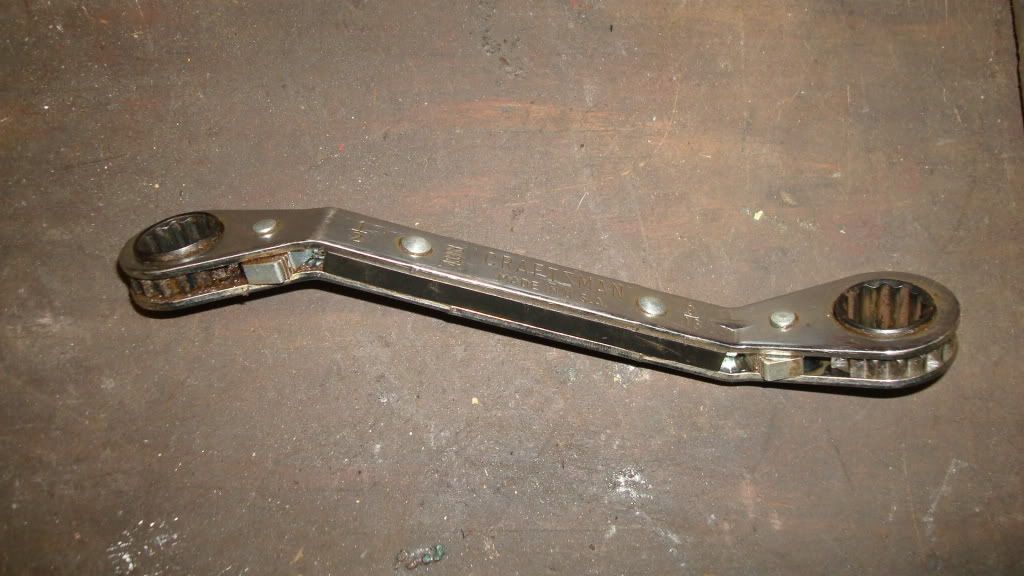

    We all have struggled with the inner nuts on the 3 bolt bearing flanges. A swivel socket jams up and comes off. Normal wrenches dont have enough swing room. It is just plain crusty adown there, and everything is in the way....., well I found a much easier way to get those buggers! I recently tore down a crusty old 1970 Max II, all 6 removed in ~2 hours with this tool. It was able to get to all 18 locations, and get at least 1 click no matter what spot!
    Great investment! No longer a job filled with anger and @#%&*!
    Looks like the ratchet mechanism can use a little TLC....how about a little oil or light grease after a thorough cleaning?
