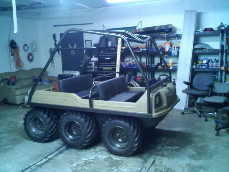

        i made this one about a year ago
          Good lookin cage there,Kegger.
          Joe.
            Looks nice!
            I like the idea of the grab bar for the rear passengers, but I also think they would be bashing their knees up against the bar.

              thanks guys...and for the leg room not sure if the photo is deceiving but its not even close to hitting my knees when i sit in the back so i don't think that will be a problem.

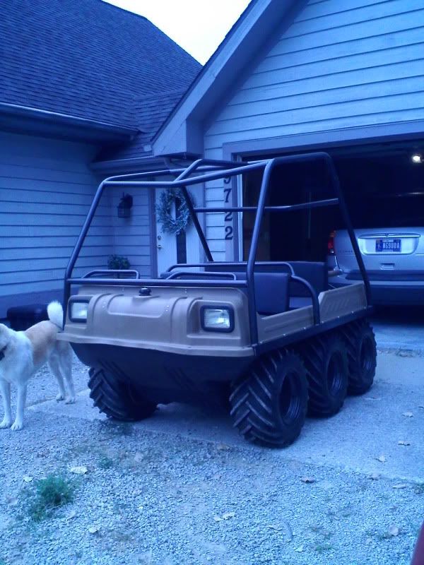

                Got it back today! Unfortunatley, there is a problem. I specified I wanted the cage 48" tall, but it only measures around 39". The measurements didn't really hit me until I got it home. This guy has been building race cars and roll cages for over 20 years. I don't know how he could have messed this up, I'd get scalped if I ever rolled it.
                Hopefully he'll make things right. The other thing I'm not too happy about is the single bolt making the cage removable. It doesn't seem like it would hold up...It doesn't even look like it's a grade 3 or 5. An easy fix, I can replace it with a grade 8 bolt. But is one enough? Other than that, I like the rest. I have a removeable tow hitch that I can move from rear to front.

                  The factory cage has two bolts at each post but one will probably be fine. How high up do the inner tubes go? There may be enough to put another bolt through? As for the height, it looks high enough in the photos? The higher it gets the more it gets hung up on fallen trees. I think it turned out pretty good overall.

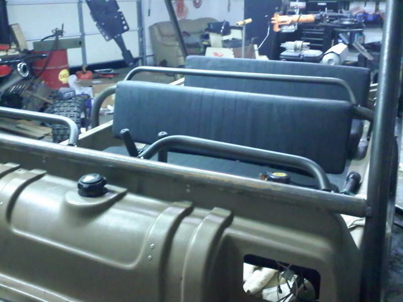

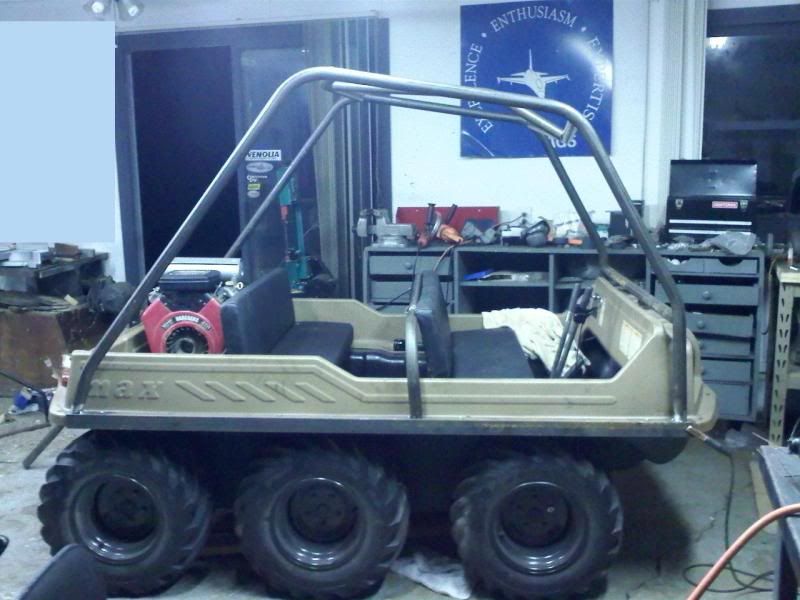

                          This is my custom MAX IV cage. It has complete surround and ties into ladder frame. Rear hoop supports the rear seat which is moved back about 3 inches. New engine cover is removed with 4 quick release pins and will carry 300-400 pounds. Front andbrear seat mounts each come out with 4 quick release pins. Top of cage includes 4 tabs to allow carrying cargo on top. Also welded plates to mount off road lights just under top of the cage. Finishing up winch mount and four tow hook mounts. Will powder coat next week.
