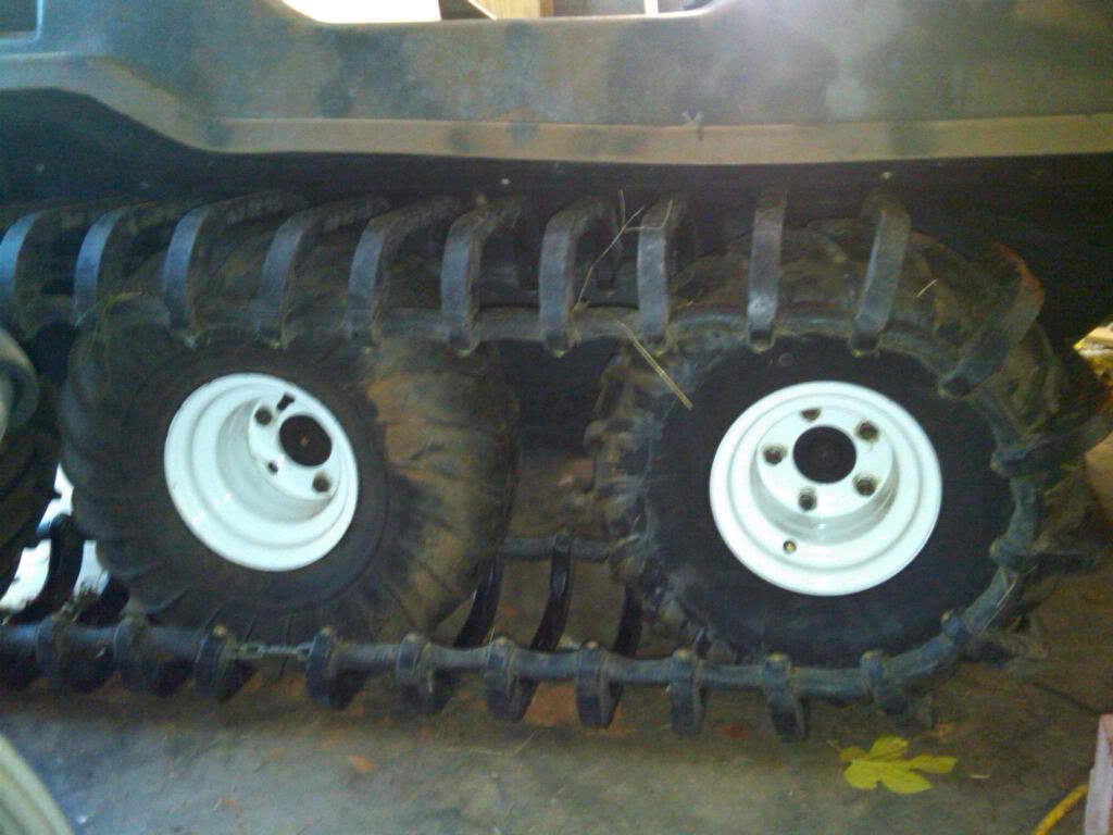

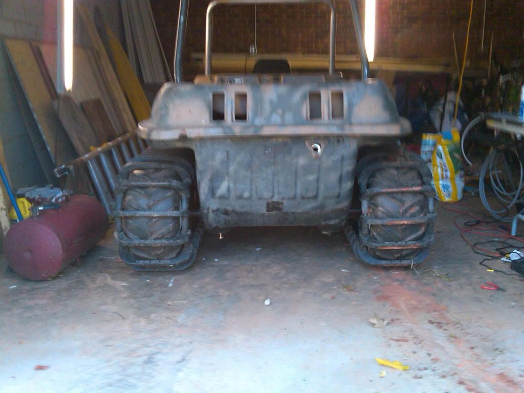

    Got a set of used adair tracks for my maxII, only issue I see is that the clearance between the body and the front 2 wheels. They fit, not binding but just kissing the bottom of the tub a bit.
    So I was wondering if anybody has heated up the body to make room for bigger tires.
    What would be the best process for doing that?
    I don't really want to buy smaller tires, so I figured I can move the body 1/4'' or so.
    Thanks
    Take a propane torch and slowly heat the tub. Then push a mold into the body and let it cool on its own overnight. That last step has been crucial for me. I tried a few times just letting it cool for an hour or two, putting water on it, etc and it worked temporarily but would eventually come back down. If I let it cool overnight, I didn't have a problem.
      I agree, this is an excellent technique. If you are skiddish of the propane torch, you can also use an electric heat gun, it takes longer to get the plastic hot, but is a more forgiving approach.
        map gas torch worked good, it was only touching at the top of the tires, so I'll see if it holds the shape, I did it last night so it could have all night to cool.
        Thanks for the input.
