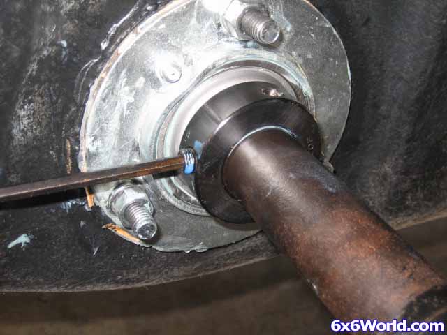

On the outside bearing, you will find two holes in the eccentric locking collar. One has a set screw in it and the other doesn’t. Loosen or remove the set screw. On my Max II, the set screw took a 5/32” allen wrench.
Once you have the set screw loose, locate the other hole on the collar. Use a punch and hammer on this hole to rotate the collar and free the cam from the race. The collar could rotate either way so if you have trouble getting it to budge you may want to try hitting it in the opposite direction.
Now using the same procedure as before, loosen the set screw on the inner bearing. Note: Some of the earlier Max six wheelers didn’t have inner bearings so this step may be optional for you depending on your 6 wheeler.
Rotate the collar to free it from the inner bearing.

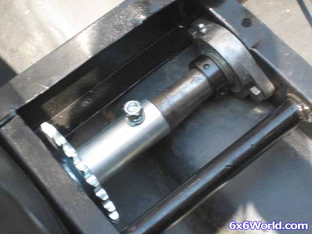

Remove the nut and bolt that holds the sprocket on the axle.
Now theoretically your axle should be free to just pull out however because many of our 6x6 ATVs are 10, 20, and even 30 years old it isn’t always that simple. Often, even after you remove the bolt that holds the sprocket on, the axle will not want to slide out. Sometimes spraying liberal amounts of penetrating oil around the ends of the sprocket tube can help but other times you just have to use brute force. A puller mounted to the lugs can give you that extra power that you need to break it free. Be sure that you put a crow bar or screw driver on the sprocket so that you have something to pull against and also so that you do not damage the tub.
If that still doesn’t free the sprocket tube from the axle you can try using heat. Place a piece of tin under the sprocket and also put some water in the tub so that you don't melt it. Then you can carefully apply heat to the sprocket and try the puller again when it is red hot.
Finally if that doesn’t work you may have to cut the axle or sprocket off. The decision of which one to cut is up to you. If you are replacing the axle the I would just cut it. Later you could put the sprocket in a press to free it. I chose to cut the sprocket with a die grinder since I was replacing them anyway.

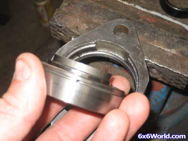

Take the inner bearing housing and place it on a vise so that you can tap the bearing with a punch to get it to rotate away from the housing. Note: After I wrote this article Dan from Recreative Industries gave me a good tip on these bearings. He said to put the flange in the vise and use a pry bar inside the inner race to rotate the bearing in the flange. Do this when removing the old bearing and when you install the new one. That is a better way than I have shown here.
Once the bearing starts to rotate out flip the housing over and turn the bearing until it can slide out of the reliefs on the housing.

Once you have the flange/housing clean insert the new bearing from the back. This is just a reverse procedure of the way you removed the bearing. Be sure that the lip of the inner race is facing the outside of the housing so that the locking collar can be reinstalled correctly.
TIP: If you look in the picture below you can see a small hole in the groove of the bearing. This is the only place that grease enters the bearing from the flange. I always make sure that this hole is as close to the grease zerk as possible to ensure that grease has the best chance of entering the bearing when you grease it.

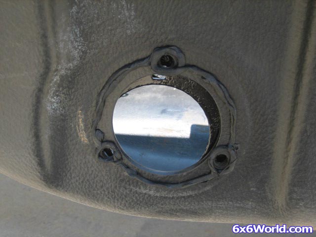

There are several ways to seal the outer bearing flanges from water. Recreative Industries used a paper gasket between the two flanges for a while. Some people use grease and just apply it liberally between both flanges. I went a little further and used silicone in conjunction with the paper gasket supplied by R.I.
I applied silicone to both sides of the bearing flange. Then I placed the new bearing in the housing being careful not to get silicone on it. Finally I placed the paper gasket on the outside flange and sandwiched it in the middle.
Note: When you put the bearing in place be sure that the lip of the race for the locking collar is facing the outside.
Now you can insert the carriage bolts from inside the tub. Put the washers and nuts on from the outside to hold everything in place. You should just torque them a little for now until you get the axle installed. I also put some silicone on the backside of the nuts just for some added waterproofing and peace of mind. The paper gasket is really not necessary when using silicone.

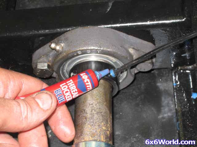

Now you can place the inner bearing collar up to the race and use a punch to rotate/lock it.
TIP: Be sure that you are not placing the punch in the hole with threads where the set screw goes.
Place the set screw in the collar and apply some thread locker to keep it from backing out. Tighten the set screw.
Repeat the same procedure on the outer bearing’s locking collar. Note: You could put silicone around the outer locking collars to complete the watertight seal.

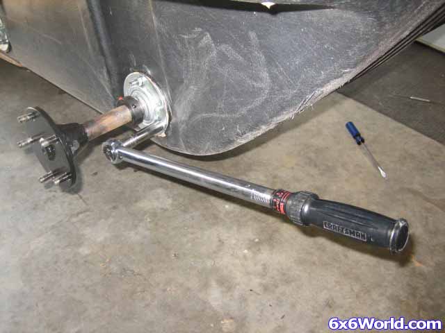

Now the axle is held in place and you can finish the job by torquing the flange bolts to 32 foot pounds. Be sure to torque your inner bearing flange bolts down too but unfortunately I do not have specific torque specs for those.
