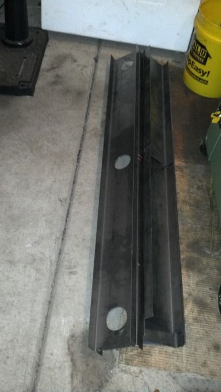

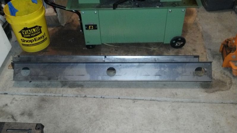

    im keeping my focus simple, get a rolling chassis is priority. today i got my metal and started by drilling the 2.75" holes. this was pretty simple to do, i tacked the two pieces together to keep stuff equal.
    tommaro i will drill the bolt holes while its still tacked together, cut 45's at the rail ends and tig stuff together.

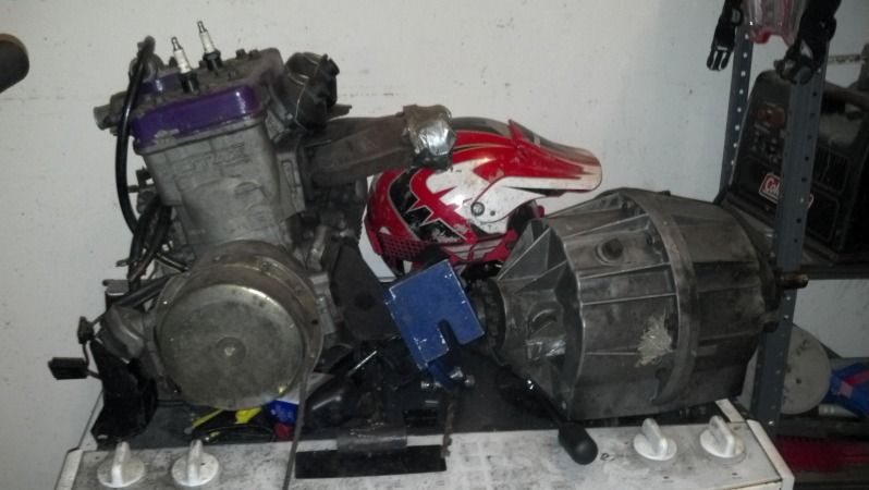

    3. im having trouble understanding the design concept behing why the transmission chains go to a secondary chain and sprocket set before linking up to the drive chains. can this be by passed in my new design? im getting custom water jet trans plates made so this is kind of important because mounting the rotax and trans will not work in stock location.
    i no there isnt much to look at now but trust me this will be a interesting project forsure. considering ive never driven one before.

    The jackshaft, instead of direct drive right to the axles is because the chains can't be run directly to the center axles because the sprockets would hit on the tub/lower body. If I remember correctly you're from the western NY area. Come hang out with us sometime and join us for a work day or two and we'd be happy to help you along!
      humm maybe u can send me some photos of the clearance issues from the jackshafts. i would look at mine but its fully disassembled.
