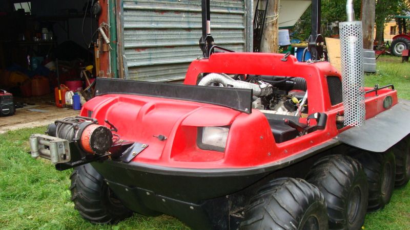

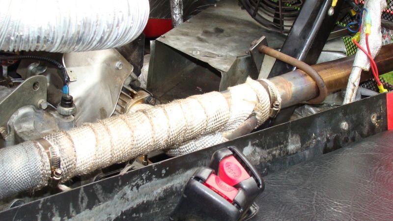

    I was having a problem with excessive heat building up in the engine compartment, to the extent that the coupling between the hydraulics and gas engine had melted and stripped.
    I had a stainless steel manifold made that went straight out to the side of the engine compartment and mounted a stainless flow thru magnaflow muffler outboard. I wrapped some exhaust insulation on the pipe to help keep the heat down. We ended up putting a heat guard around the muffler to keep the burns to a minimum.
    Oh ya also put a ramsey winch on the beast , this one is removable and will fit in the rear receiver if needed.
    Here are a few pics of the new set up.

          Did this new pipe solve the heat problems? Thats a great looking weld and fab job. I have to do some sanitary s/s tube welding almost every week as I work in a food processing plant. These over heating problems should have been solved at the factory especially when you consider the price of a new Mudox. Do they have the ability to install an oil cooler or extra cores to the radiator? Does your hyd oil over heat as well?
            so far the heat issues have subsided, when you combine the heat from the exhaust and the heat from the hydraulics it seemed too much for the plasitic coupler to bare (it sits right in between the previous muffler and the hydraulic pump). I don't feel I need to beef up the hydraulic cooling system, the rad and fan seem to be doing their job adequately.
            I may have to change the magna flow muffler I currently have since it's a flow thru and the machine is quite loud at the moment. If I get a bigger diameter muffler with an offset design I think all of the heat issues will be a thing of the past.
