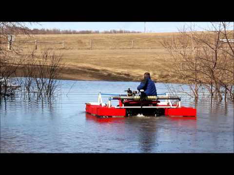

                    This is a similar idea.
                    • #85
                      Thanks mudbug for posting this video.That's the one i was talking about.
