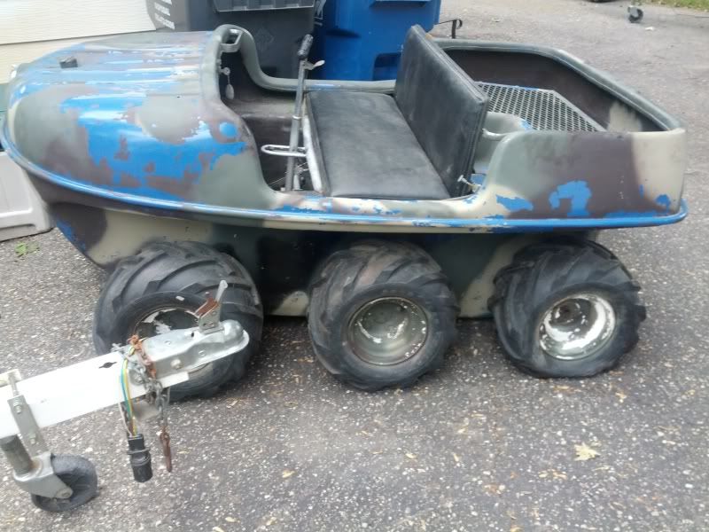

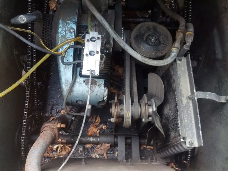

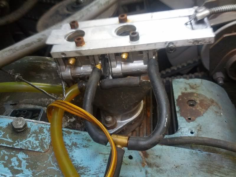

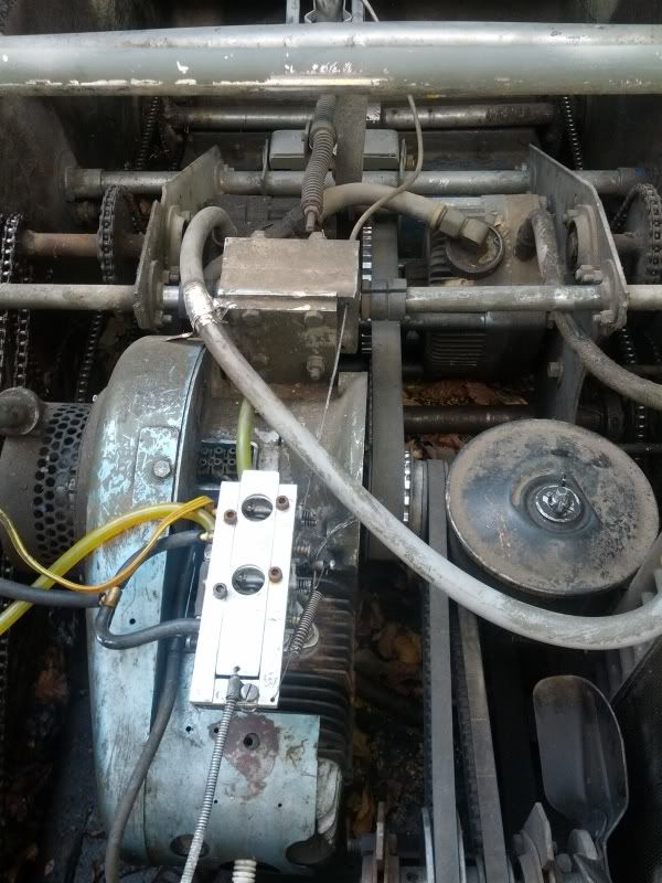

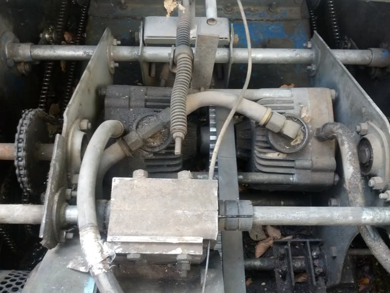

    Just picked up a Jiger Versatrek. Unsure on the year. Mostly complete. Serial number is hard to read. Has the original Hirth 246 with what appears to be a custom dual carb setup. Not sure why this was done. I'm not sure what my plans are with it. Part of me would like to keep it original but the other part of me wants something reliable. The guy I got it from said he drove it around a little. It does run with some gas down the carb. Unknown on the hydro's.

    A very cool vintage AATV.......the later model Jiger with hydrostatic drive. Here's the best site on the net for Jigers. You'll find most if not all of your answers here:

              Great find there, I redid a versa a couple of years ago and loved it (rip) It looks like you have it all there, so run it like it is if you can. maybe a little clean up if you like. The intire engine and hydros will come out in one unit and makeis it super easy to work on. These are very lite in comparson to any argo or max. I think they are around 450 lbs! you could change the driveline with relative ease but something that good of shape it would be a better candidate for restoration. good luck and oh ya, you will definately want reverse.
                sorry, i forgot to mention that the dual carb is factory.
                    Wow....I would have never guessed that. Thanks!!
