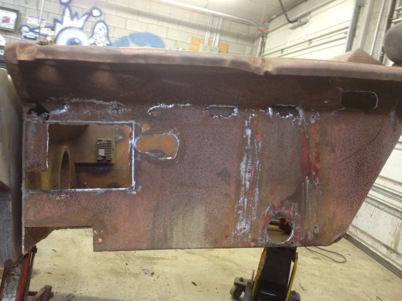

                  Well, Left side is DONE for now till i get wheels back on and then i can work on my "Guide Rails" imma build...but thats for later..lol Here's a few pics. Dont mind the mess i made of it, some area's of the coot i just had to work with what i had...the old metal was getting thin, and im glad i decided to add to the body metal cuz it needed it!! Some welds were done with Mig (important ones) and some were done with the Stick....might i add, STICK welding that old thin metal is nerve wrecking!! Ugghhhh!!! Also, on the side you'll see where some areas were grinded on....those are plug welds. I pulled the new metal into the old metal, then welded them together. How did i pull it in you may wander??, Cut a hole in the new metal, weld a bolt to the old metal, then run the new metal down against it with a Nut and washer, or piece of flat stock if you have a large area thats "gapping" underneath.
                  NEXT ill be on to the right side..in some of the pictures i posted earlier, you can see that i had MAJOR holes in the bottom of the tub, well...got some on the side too as seen in the following picture. Once i get fender cut off and dash re-fitted as needed, then i can begin welding new fender into place. Once fender is in place and tub is attatched properly, i can then go back to putting front wheels on...which will DEFF make it nicer to move around..This big steel tank is heavy!! lol I had to post a "question" over on coot world about wheel bearings, cuz my front ones have NO numbers on them..makes it tough to Cross ref them! lol Anyhow, enjoy boys and gals!! Ill be back with more im sure!!

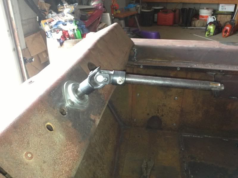

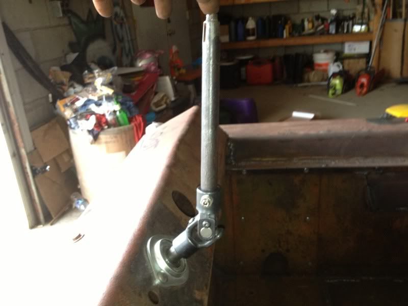

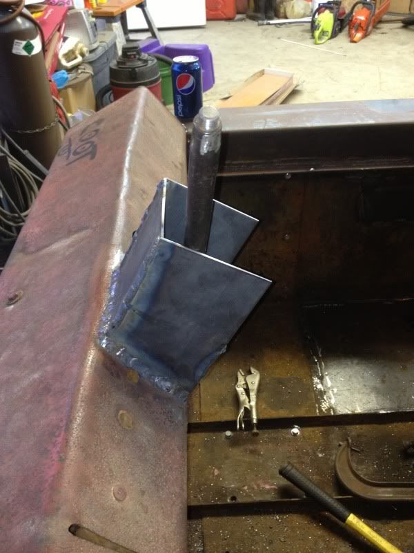

                            WEll its been a while since i updated my build..i have no pictures at the moment, but ill get some. Pretty basic stuff. Finally got new panels all welded on, front spindles re-built and packed with new grease and bearings. Steering Mechanism all cleaned up and working very free. I even cut a board and made a Hobo-seat. lol Just temporary to see what i would be working with for steering wheel placement and leg room, etc etc. (NOTE: i did not build my TT box yet, however i have all the bearings found online/at auto parts store and all are ready to be ordered..enough for both boxes too...which is about 150 bucks..) ANyhow, metal fabricating is going on right now and i had this bright idea to give the coot a tilt steering wheel. Something that would allow easier entry and exit. Tonight i made cardboard cutouts of the Stand, and tilt mechanism. I copied the idea from some pictures i found online. I have a new 3/4 bore universal joint for joining shafts in the garage, only problem i found was that one side is smooth bore, other is splined and is only 11/16th ID...so ill have to open it up a bit. Not sure if i can just hit it with a drill bit or not...so i may have to chuck it into a lathe and do some work on it. SLOWLY, but surely it is coming along. Once i get TT built, i intend on retrofitting some outter sealed bearings rather than axle tubes. Oh, and i also need to cut my big plate for the front of coot and weld it on as well. THen i can build a Super Mega Bumper and all that other good jazz (winch mount, Clevis eyes) Also need to cut smaller plate yet, for the Steering Rack Re-inforcement that i read about as well. The Front half of Coot is gonna be the expensive half..lol LOT to do yet that i haven't mentioned, however by next year for ashtabula, i should have the ole coot ready to play with yinz guys!! :-D And as i said, ill get pictures of my slow but on going process! Stay tuned!!
