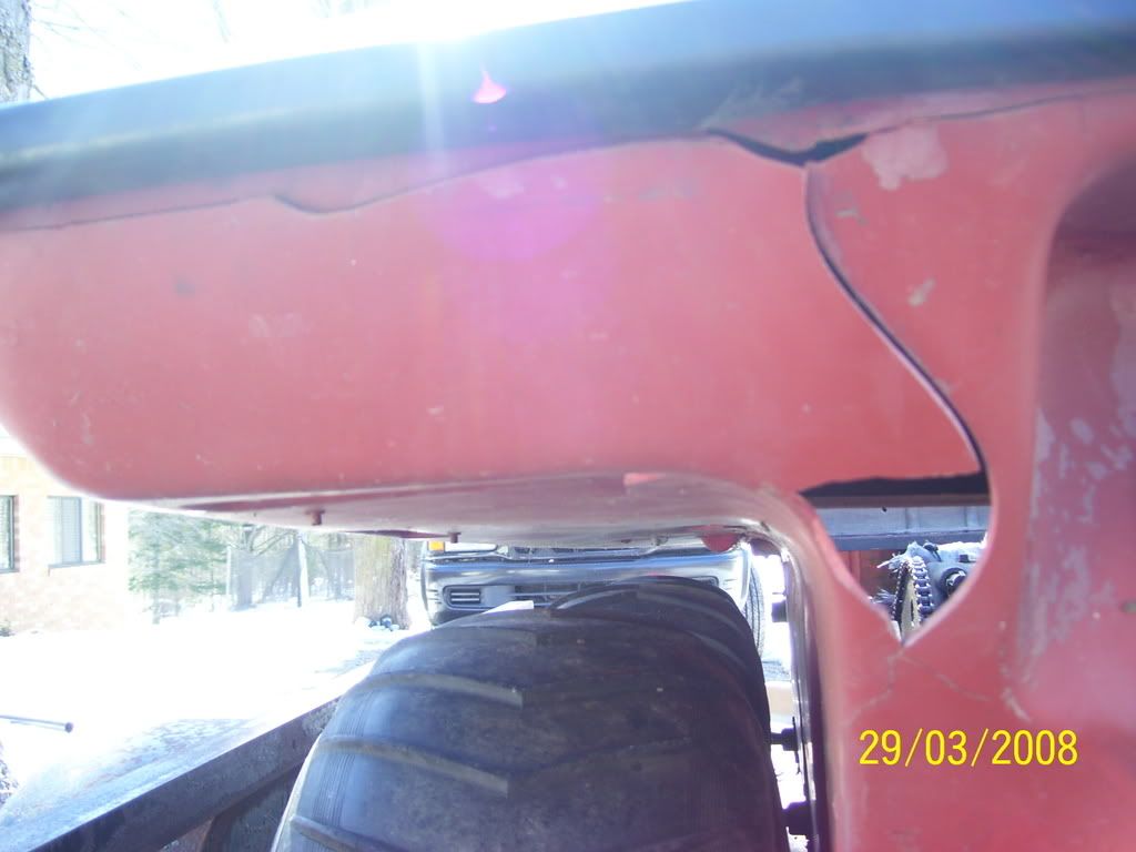

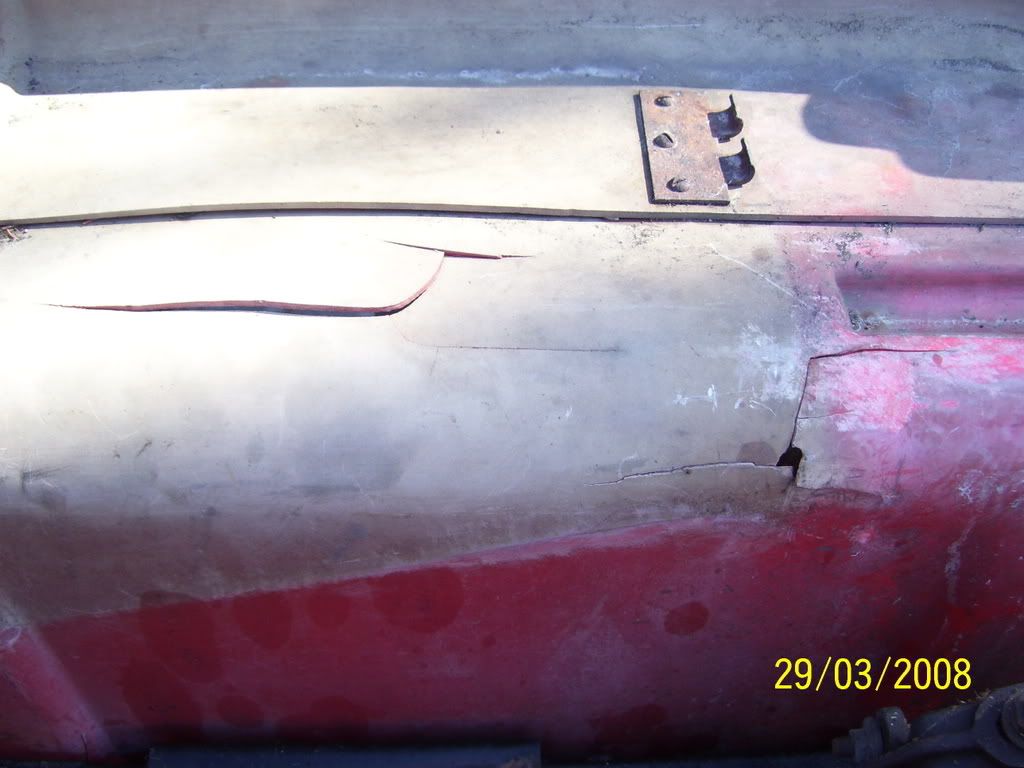

                          I have an Amphicat body that's very beat up. I was wondering if anyone has ever repaired a body that was in very bad structural condition. Is no body to gone to repair? Or is the plastic to brittle to ever ride on? I have a big mat of what I think is ABS, and I have acetone...
                            My other post got moved to this thred, thanks mike My body seems really brittle, even if I repaired it, would it start to crack again? Has anyone ever made some sort of skidplate that bonds to ABS... I was thinking of that. I have no doubt that it could be repaired, but I don't think it will hold up to even normal riding stress. Here's some of the cracks:
