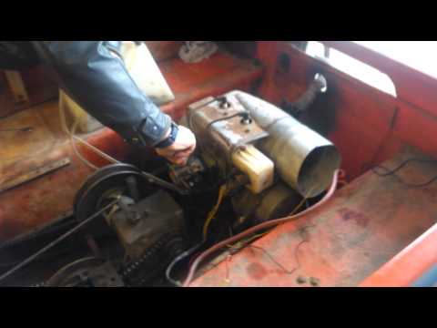

          after a close look and dismantle I see everything in good condition.. gaskets are not as old as the carb.. but I'm missing the low speed needle and the cable clamp/ lever for the choke. Before I do to much I'm going to check the motor over good.. compression and such.. no point in the carb if I need to look at a different motor. Would be nice to keep things as original as possible but I would like to use the Bazoo not just look at it ..

                              It's alive ! rebuilt the Walbro.. fired up the CCW 400
