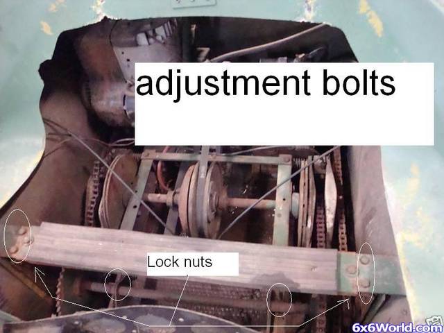

                Hi pakldr, sorry I only saw this just now, I had the same problem and it's a super simple fix, a lot of people replace the clutch lining but it's not always necessary. What happens is the engine drives the wheels after going through two friction clutches on either side. These are the ones where if you steer to the right tor left they open up so as to reduce friction and let that side freewheel or slow down. These machines are very old, and the heavy duty springs that keep the pressure on these plates will lose some tension over decades of sitting around.
                You won't find this when you look for it as it is hidden in what looks like a solid block of steel where the hydrological lines go, never fear it is super easy to get off and once exposed just crank down on it until you have the tension desired. I tightened right down until I couldn't get to the nut anymore. Note that the tighter you make them the more traction you'll have (at a point you will have WAY more than necessary to never get slippage again which is what you want, but as it gets tighter it takes more force to overcome the springs with the steering wheel when you turn. This can make the steering feel really heavy and take more effort, but the result is your machine will turn on a dime under all circumstances as long as your don't psychically get stuck.

                  Thanks for the info. I think I'm going to do both as as one side seems to be medal to medal no material at all. Just got to get the clutch material. Again, thanks for the info
                    No problem, yea it is very possible your clutch material is worn down, not to mention you really want the same thickness on either side, good luck and post back the results!
