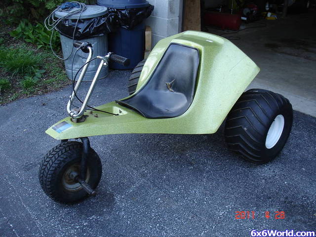

Tricub tires

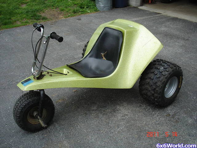

I finally decided on 18x10.50-8 rear tires as modern replacements for the original balloons. Regarding size and shape, these are near perfect match, but obviously the tread pattern is different.

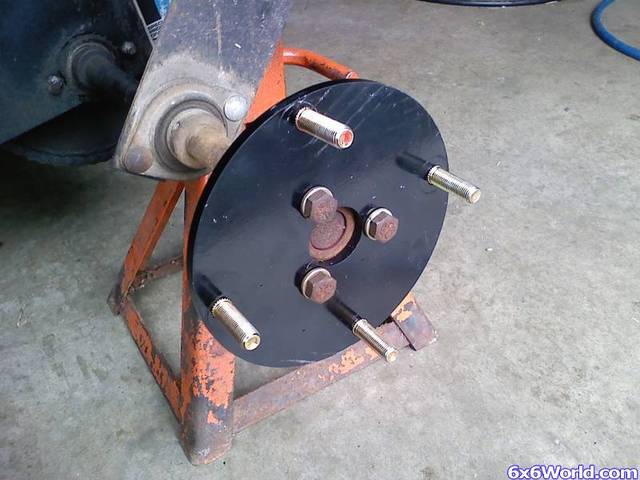

I made wheel adapters using custom laser cut discs and studs that I found at a Polaris dealer.
I borrowed a set of Carlisle AT 21x11-8s and tried out. These look more like the originals but there was noticeable reduction of power with this larger diameter tire and the 5hp Briggs. These tires would probably be ok with 8hp Tricub.
Now I can ride without having to air up every ½ hour.

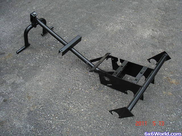

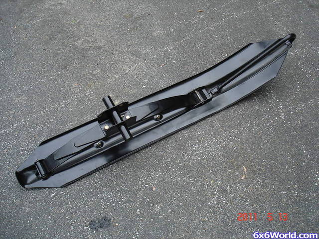

Also got the Tricub ski and Minicub frame back from powdercoat.

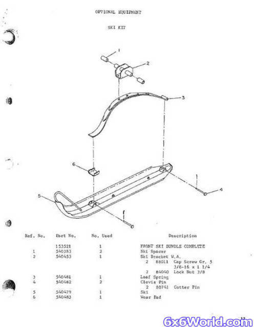

Hey John... The original Tricubs that I have seen in person and in early ad photos all have the tire chevrons pointing toward rear as viewed from top. The general consensus is that this configuration is best for more fluid-like surfaces... sand, snow, wet mud, water (AATVs). The more traditional tractor config (chevron pointing forward) is better for firmer surfaces like turf, dirt, thick mud, etc. The ski on mine is SPD factory ski kit. It looks very close to sled skis from that era, but I have not yet seen exact match on any production sled. I believe that SPD bought this ski as shelf item and added the axle bracket to create their kit. They offered this kit on Tricarts and Tricubs... only added spacers for Tricarts to make up for longer axle length.Originally posted by rungmc View PostI have to same tricub as you do. my tires run with the point of the tread to the front like a farm tractor. I like the ski idea. it looks like an old snowmobile ski, is it? Know anybody with a seat for sale? Thanks, John

Tricart/Tricub ski kit
