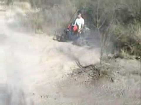

          That mini tracker is awesome! I like how they made the tracks by cutting the sidewalls off some truck tires. Instant endless tracks! I wonder how the transmission is set up.

                  The reason I posted this video is :
                  A forum member once talked about making a track system for an amphib out of discarded , rubber tires . This video shows some one who has done just that . I also posted this video for people that are quite handy building things , and may want to build some thing like this , that is non amphibious , for 6-12 yr old .
                    It is turned by tensioning and un-tensioning a lawnmower belt on each side.
