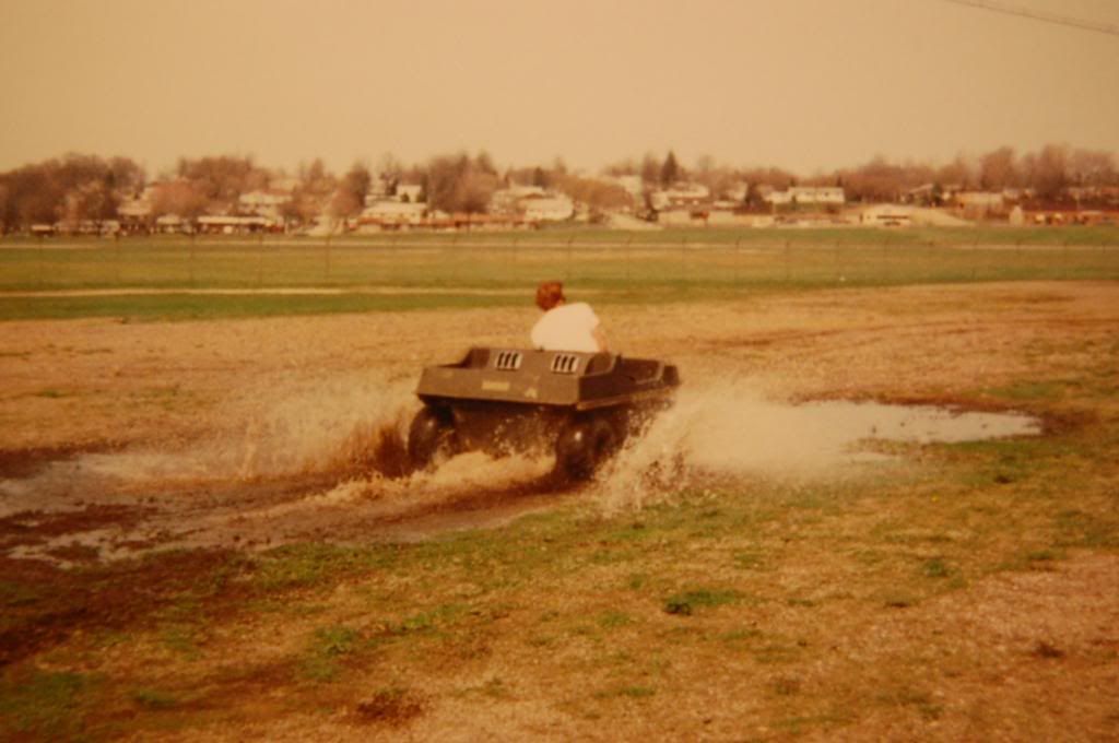

                      Here's Chuck (Cirrus6) in the Camel Centipede back in the late 80s - early 90s...
