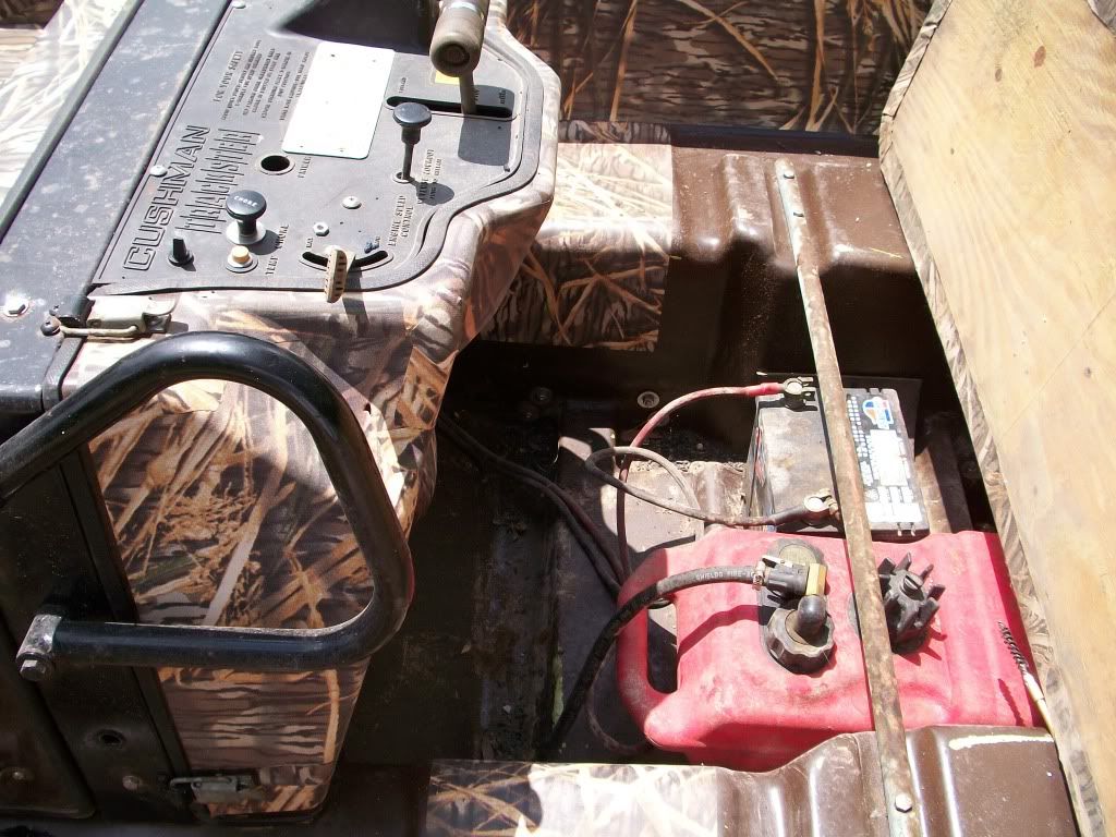

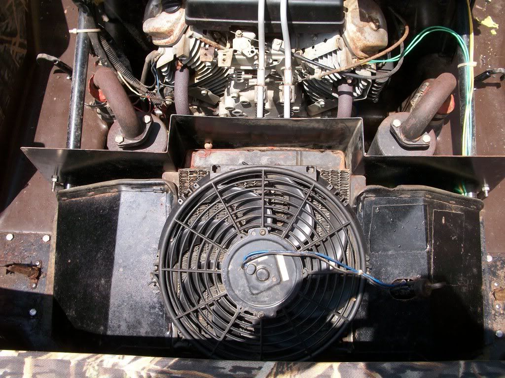

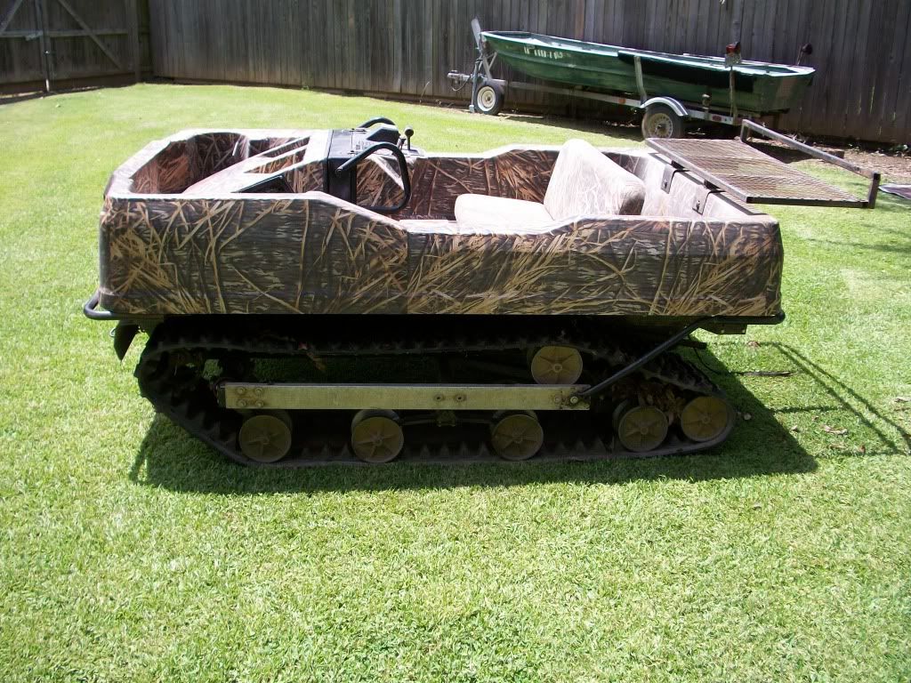

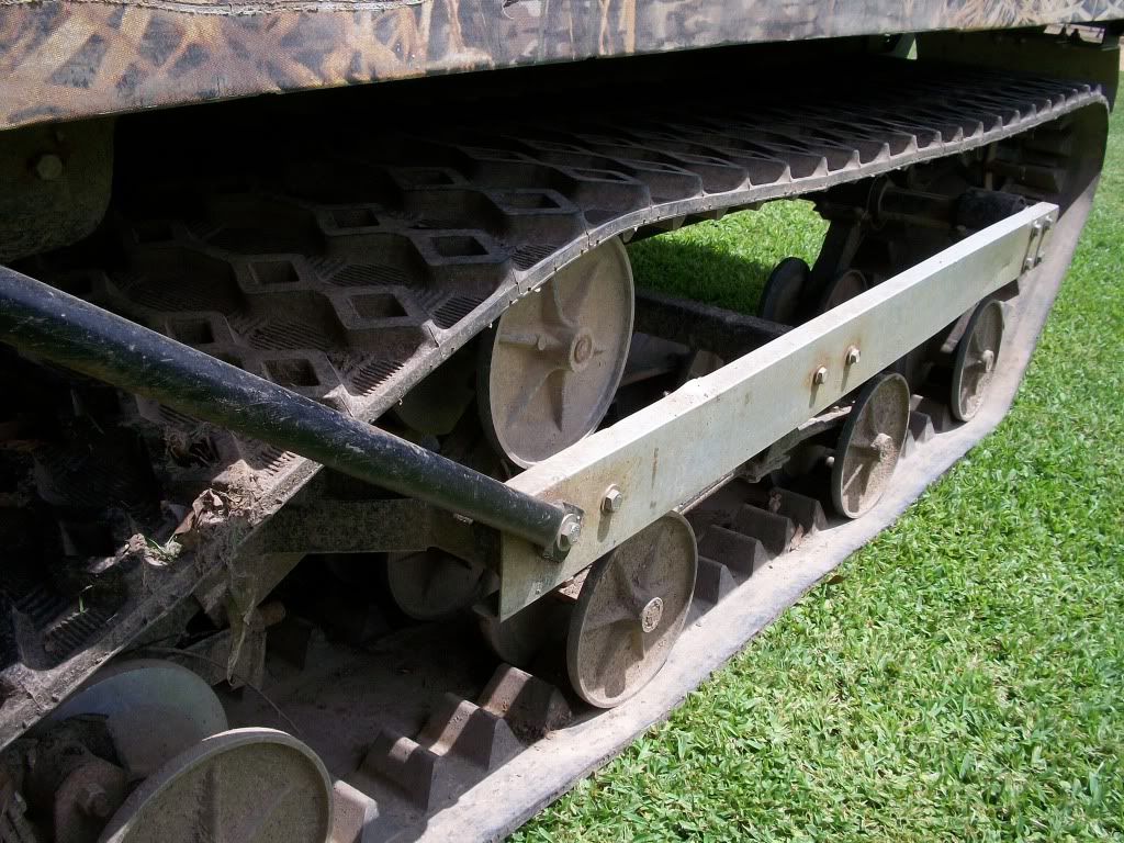

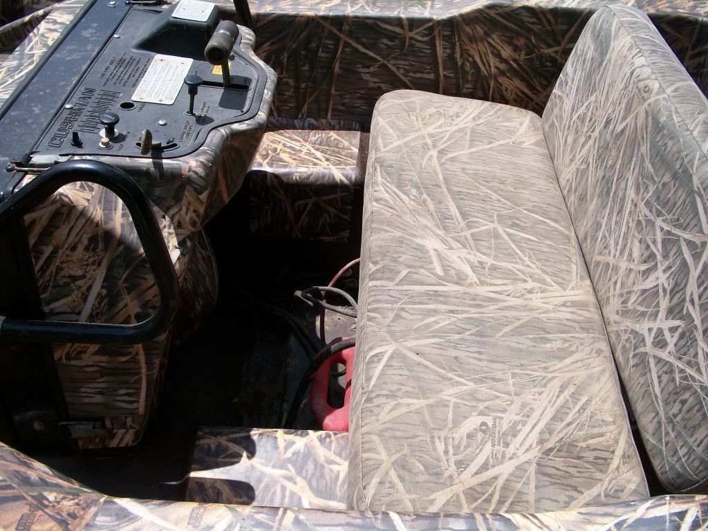

    brushcutter I'm in Natchez, Ms. Here are some photos of mine.

          • #50
            What makes you machine swim? I can't see how the shape of the lugs on your tracks are able to give any water propulsion at all. Does it use a jet pump in the rear?

              • #52
                mudbug, there is an angled piece of metal located at the front of the machine above the track. It is visible in the first picture I think. That little piece of aluminum traps the water being pushed by the track and is what makes it swim. It is required if you want to move at a decent speed through the water. A buddy of mine has practically the same machine and put a trolling motor on the back of his to make it swim faster. Honestly the machine will swim just fine without the trolling motor.
                  I was also curious about this. I see the deflector but just don't understand it. It sits so low in the water you would think it would not move at all without some sort of outboard like this guy has.

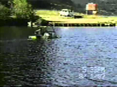

                  • #54
                    That's a good video. Wonder if that water had current. My cushman seems to swim about that speed without a motor but there is no current in the water I've been swimming in. The new tracks that I have seemed to have a little more paddle or tread than the older tracks that I replaced. I have a faster transmission than the older models too. I don't know. I will say that it really helps when you have two people, one running the cushman and the other running the outboard or trolling motor. The T-bar steers the cushman pretty well in the water.
                    Well never mind I just saw that that was a river crossing. It did well. I've crossed water with three and four people in mine but we had to shift around to equal the bouancy.

                      • #56
                        ashland
                        If your trackster swims as good as the trackster in the video with the 2 hp out board motor on the back of it, it swims good enough to suite me.
