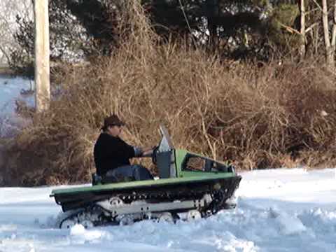

      Great looking Trackster, looks like it has a new set of the Chemoplast tracks. Here is my thoughts on the engine. Unless you are wanting to keep it all original, I would not rebuild the original engine. They were noisey, low on torque, smoked, just a bad idea from the start. Convert it to a 4 stroke, it will be a much better machine. You don't have to change the ring and pinion, you are only going to loose 2-3 mph by staying with the stock gearing. The OMC engines were goverened at 5600 RPM, a modern 4 stroke is governed at 3600. The 4 stroke has much more torque, you can drive around at half throttle and have plenty of power. The OMC engine was only making power if you were running it against the governor. I see your Trackster has the optional 9 tooth drive sprocket, vs the standard 7 tooth, so you'll have plenty of speed even with the 4 stroke. Tracksters weren't speed machines anyway, what they did well was go anywhere. You can buy one of the Honda 24 HP engine kits, but I personally don't like that kit because of the way the engine is mounted on an angle, and the way it is coupled to the transmission using the stock stainless steel flex plates. I installed an 18 HP Briggs Vanguard in one of my Tracksters,( plenty of power, BTW), I mounted the engine level, and made a driveshaft out of parts I bought at Tractor Supply. I've been running this Trackster for 4 years now, with no issues. But whatever you decide, get her running, you'll like it, very usefull machines...
      I shot this vid right after I got it running with the Vanguard, I'm only at just over half throttle .
