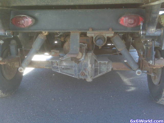

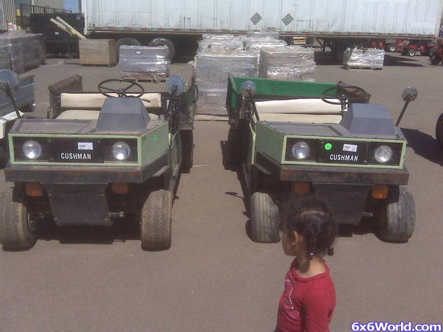

    I just picked up 2 identical 1986 model Cushman mini trucks at auction. I believe they were called Cushman Haulsters or Trucksters... I know they are not AATV's but their powertrains sure seemed like they would make great transplants. even considering one for my PPT...
    talk about ultimate utility vehicles these have 3 speed trannys plus reverse, 2 cylinder (OMC) horizontally opposed engines, High low 2 speed rear axles, actual rear PTO, factory 110AC converter, dump bed and an auxiliary hydraulic pump.... From what I gather they are capable of pretty good ground speeds (50mph) I will go pick them up this morning, no idea what they need to get running but both came from a government municipal surplus auction so prob govt owned since new..
    If anyone has more info on these, let me know. Here are a few pictures of them

    Well I got them home and cleaned up a bit... The engine is actually a 22hp engine. being that it is long. narrow and relatively flat, it would be a good candidate for my PPT with a custom designed hood. (think 2 cylinder version of an old VW engine). I know that the old Thikol snowcats used stick shift transmissions with an open rear differential and brake activated steering. Considering swapping the trans and rear end over to the PPT also or looking for the parts to go with a hydraulic drive... If i could adapt the rear axle I would get the benefit of the 2 speed rear end and existing brakes. then I could just plumb each side off a seperate line for steering and using the original variable drive clutches from the engine and tranny on the PPT now.... I think the hydraulic setup would work best though. need to find an old zero turn mower or similar vehicle for the Hydraulic parts donations Or find me an old AATV tub and just custom build using the whole powertrain from the cushman
