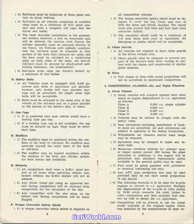

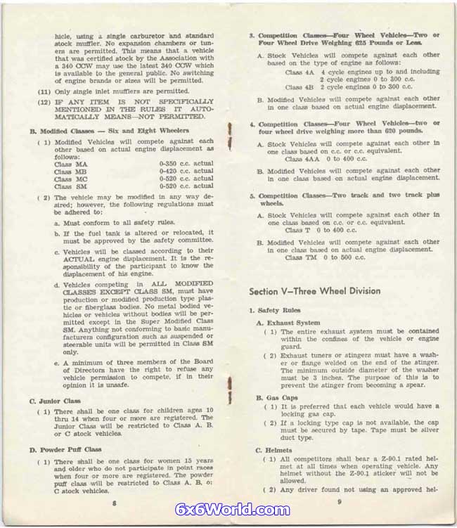

                    • #25
                      So, if we're going back to the 1975 stock rules, it states that only single carbs are allowed, and no swapping of engine sizes/brands. I won't complain (okay, maybe a little bit...) but it's tough enough for the little 440 purists out there to hang with the G50B crowd, and even harder to keep up when the big honkin' Rotaxes pull up to the line in D/Stock.
                      "Competitors will be allowed to use the latest model available of the original engine which was installed by the manufacturer in their vehicle using a single carburetor and standard stock muffler..... No switching of engine brands or sizes will be permitted."
