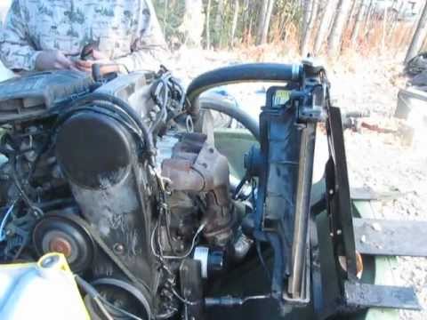

              how about a 1000cc 3 cylender. Weighs 15 lbs more than the liquid cooled kawiasaki, AND run snow machine clutches
              ATV = Alaska Terain Vehicle
                Thats only 15 lbs heavier than a FD620? Looks like alot more metal there. You're going to have to fab up some type of engine cover for that beast!!!!!! Is that a Geo Metro engine?
                  Yes sir. The geo metro engine is a Suzuki G-10 engine. THis one is a Throttle body injection model from a 92 metro. Their also found in suzuki swifts chevey sprint engines... i think i may be missing a few.. oh a fire fly too.
                  What makes it light is it is ALL alumanum, even the radiator. Subaru justies have a 1.0 L engine, but it is iron, and there for not suitable.
                  I only swapped to it beacue it was the cheapest route to get an altinator and fuel injection. Look around the site, there are vids of another argo with a chevey engine in it... good vids too.
