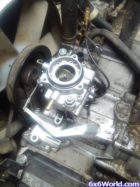

    The "new" shiny carb.
    I hardly had an opportunity to work on her yesterday, we threw (my wife's idea) a gender reveal party with friends and family. We are having a GIRL! I'm pumped and already wrapped around her finger.
    Congrats on the good news,,,, It's a Girl!!!!! Now for sure, you have a valid excuse to buy another gun!! I bought two when my daughter was born!! Congrats
    Man,,,that carbs looks like you went down to the Kawasaki factory and picked up it up off the shelf!! Good work!!

                          I'm a crappy thread host I should have been staking pics today but I was in the zone and in a hurry! On the phone right now but basically the throttle valve was right side down, but rotated 180 degrees the wrong way. It closes smoothly now. It idles with the correct RPM now. Crazy, the manual said install with numbers down but didn't specify the direction. I'm still excited to replace the springs, I massacred a few of them. I used a router to make a bigger groove in the throttle cable/handle assembly. It gets pulled back by the spring again. Took a few turns around the house today and she ran like a top. Couple more issues and still need to followup on everyone's recommendations, will check back!!
