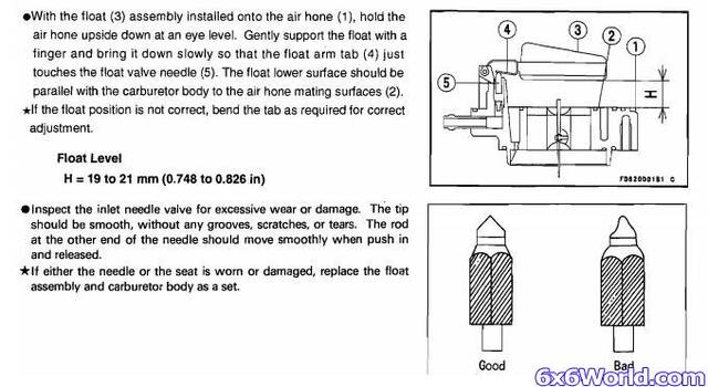

                    The picture there isn't very good. If you've never seen a float and needle before then that thing is't helping you.

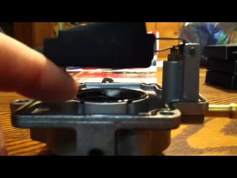

                    Hold yours upside down like in the picture and take a pic and post it. What I want to see is if you have the tab between the valve and its little keeper wire. If you have it on top of the wire then you effectively have your fuel shut off.
                    • I'm headed home shortly. I will have a pic by tomorrow.
                      There is a little wire, maybe the "keeper wire" that "clips" (fits in a groove) on the needle. The wire has a little rectangle that slides into the tab on the float assembly. The needle is connected to a tab on the float assembly by the little wire thing.
                      I adjusted the tab according to the directions above.
                      • Well, that sounds right. But you gotta admit, that's a terrible picture.

                              This is how I interpreted the float adjustment:
