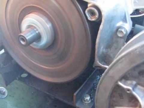

Hi guys.  Im having a hard time traking the "rattle or Knock of doom down"
1. Dosent do it when cold.
2. Less pronounced when it isnt loaded.
3. Bought a mechanics stethoscope and checked every where, it is loudest on the bolt of the rear motor mount on the clutch side.... But when i move the stetascope up to the bolts that bolt the motor mount into the engine, it gets quiter? And it is absolutly silent when checking the block....
4. Dumped in 8 Oz of marvel mystery oil, and it seems less loud?
Have a listen and give you .o2 cents please!
Turn it up! I is easier to hear.....
And no, sorry hydraulic lifters with no rocker arms to adjust
  Wish it had rocker arms to adjust.  the Lifters are supposedly "self adjusting"
Going to buy an oil pressure gauge and check the timing i guess. Throw out any and all crazy ideas!
oh and the crank is tight as a heck still, no pay there.
OHHH i have one DOUBLE CHECK HOW TIGHT THE MOTOR MOUNTS ARE!!!!!! Any other sugestions?
