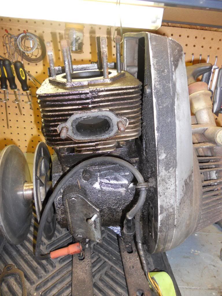

    Has anybody on here messed with tearing down one of these single cylinder JLO motors? I am considering doing this with the one out of my ST/300/D, but may not do it if it is too much of a pain. For being as old as it is, it could probably use a good cleaning and probably some new gaskets/seals.

    I did a compression test today and it read about 85. Should this be about right for its age/visible condition? Would doing a re-gasket instead of a complete rebuild be anything I should do instead?

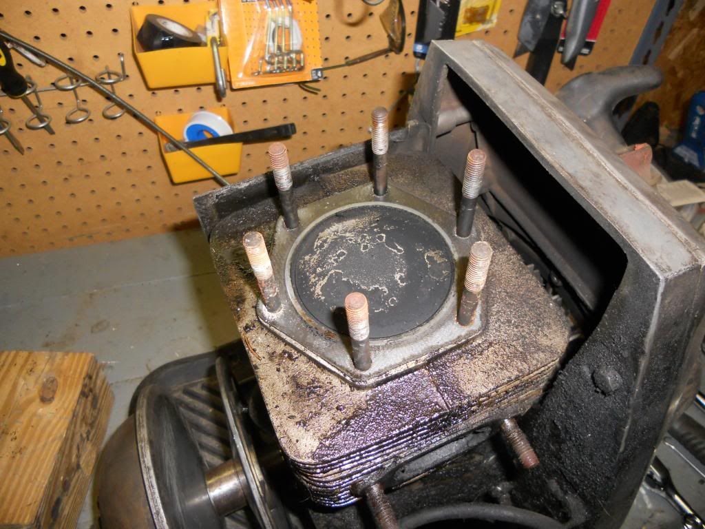

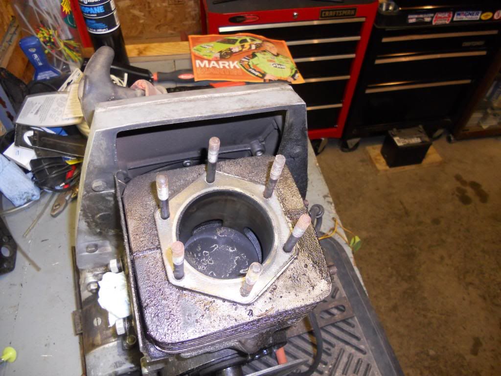

                Thanks for the link Jeff. I took the head off yesterday and I thought everything looked pretty good from what I could tell (aside from all the carbon build up).

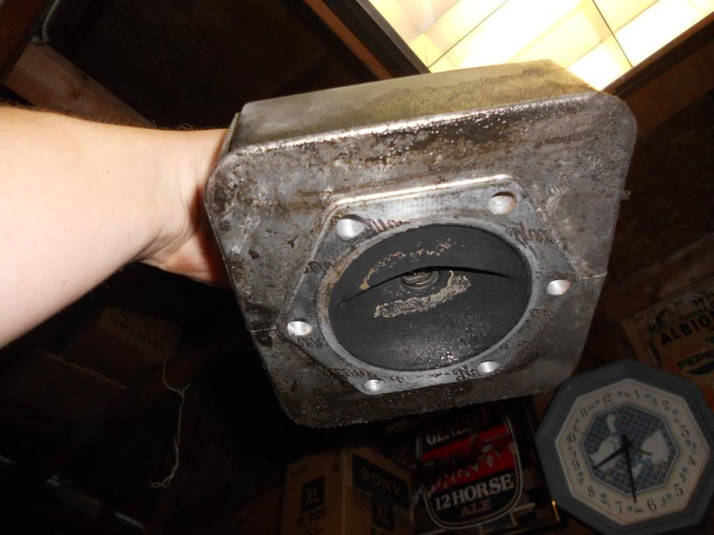

                  Looks like the gasket was leaking to me.
                    What makes you say that? Just all the gunk built up on the top of the jug or is there some sort of sign on the mounting surface that would lead you to think that? I have a little bit of knowledge on engines, but this is my first actual overhaul.

                      Wheres the oil on the head coming from?
                      In the first pic the gasket looks bad at 7 oclock.
                      The lower gasket looks worse.
                        Ah, gotcha. I see that at the 7 oclock. And yeah, there is oil everywhere, from top to bottom. It's hard to pin-point where it all was coming from

                          Pull the jug and look at the gasket on the bottom.
