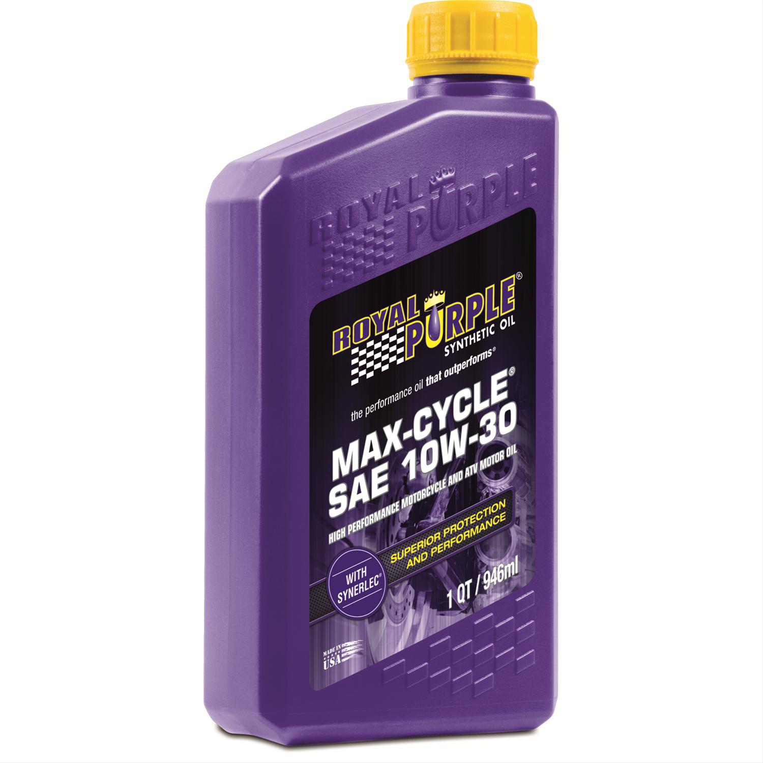

          Any oil will work for the first 20 Min run to flush out any crap floating around in there,
          Everybody has there own oil they swear by but this stuff is MFG'ed just for hot running air cooled engines. Its not cheap but ya only need 2 qts, I use it in my vanguard pulling tractors and they take a 9K rpm beatings all summer long. works great for cool weather start ups also.
          I would buy 2 oil filters and install a new one after the flush
          Free Shipping - Royal Purple Max-Cycle Motor Oil with qualifying orders of $109. Shop Engine Oil at Summit Racing.

            This has nothing to do with this thread but one should Never use Synthetic oil in a new engine of any kind, MFG recommended break in oil is key to a long running engine along with Synthetic oil after break in
