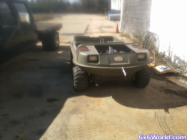

      Took Phil out today for about 15 minutes to see if everything did what it should before making permanent stuff. So far I'm impressed by the response and power, but 15 minutes of donuts and drag racing is no 4 hour trail ride or 33 hour (what we put on at Busco this year) trial.
      Looks like we are going ahead with this build and a couple more weekends of customs should cure it.
      Fred if you think you should try one, buy 2 or 3 and have spares to finish the weekend just in case, will be the same cost as 1 reputable engine.
