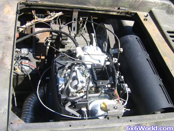

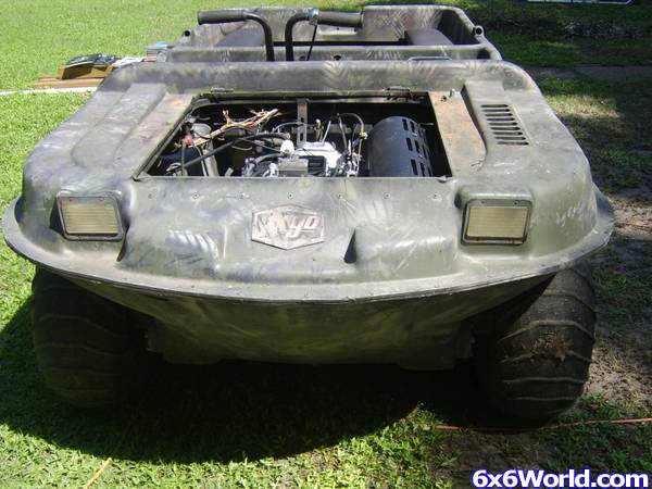

                  Here is a pic I found of a Predator in a Response ( same body/hood style) notice air cleaner is no longer mounted.
                  These pics show muffler will distort the body as shown.

                        The Predator engine install pictures that you provided looks very similar to the Subaru/Robin Engine install that I am planning. Do you have more pictures that show the exhaust details?? My muffler looks just like the one in the photo, and it will end up in a similar location. I wonder if this will cause excessive heat into the tub, and/or melt the hood plastics??? I also would like to know where the exhaust tail pipe routes to the exterior in this set-up?
                          Rick,
                          that picture was a web find of a predator in a Response 8x8 which has the same nose configuration as your machine and was a 18hp vanguard. That picture shown I'd be concerned with body heat, if it were me I'd do something different with the exhaust preferably using a set up like you have now either fabbed by you or a local welder.
                          Again I would check all clearances, though as Zuk wrote anything can be fabbed to make it work for proper spacing and alignment. I do have pictures in my gallery of "Phil, the bastard " which is a Conquest powered by a Predator with some pictures to reference. NOTE; the Conquest has a higher nose/hood configuration so take that into account, but it will give you the general idea of what was done. I would have changed the exhaust had I still had it, but it worked with all the shielding.
